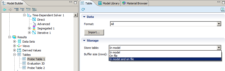

Deepak,
After you have created the table, activate it on the model builder. You can set the storage using the Table options window. Change 'Store table' to 'In model and on file'. Screenshot attached.
Hope it helps.
Tolga

I have a seemingly siilar problem. (using comsol 4.2a) My parametric study on a time dependent problem outputs the desired parameters and values to the "accumulated probe table", howoever it seems to have a maximum size, and only keeps the last 10000 lines.
However, the screenshot you posted has the "storage" field, which I can't find. Are you maybe using 4.3?
