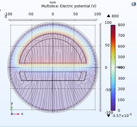

HI, i have two parts in a chamber where one has potential and the other is grounded.
Anyone has any idea how to altternate the electric potential from +800 to -800 with respect to ns?
Kindly find the pic for reference.
