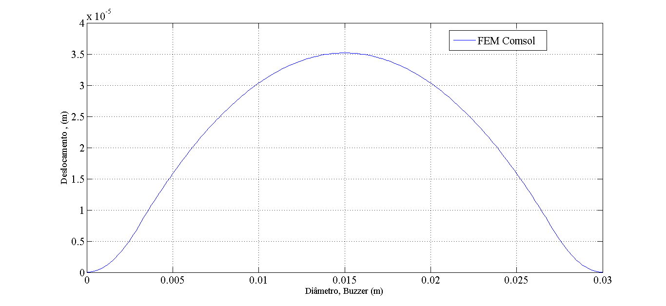

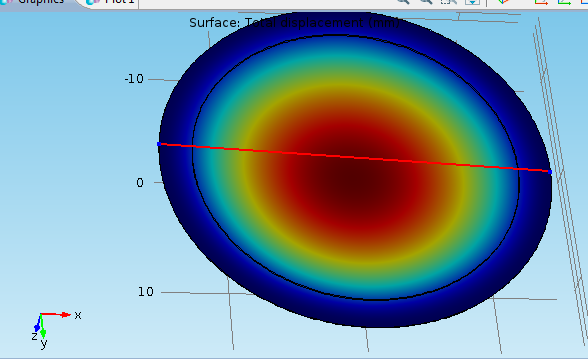

Dear Comsol,
I'd like to calculate the volume formed by pzt to be deformed, when applying a DC voltage.
How can I make this calculation in comsol ?

Dear Ivar,
Thanks for your reply.
The variables that are see, u, v, w. Where do I find deformed elementary volume?
I tried the top vol = 1 (1), but the value does not change, when the voltage pzt change.
I have attached the model.
thanks a lot
