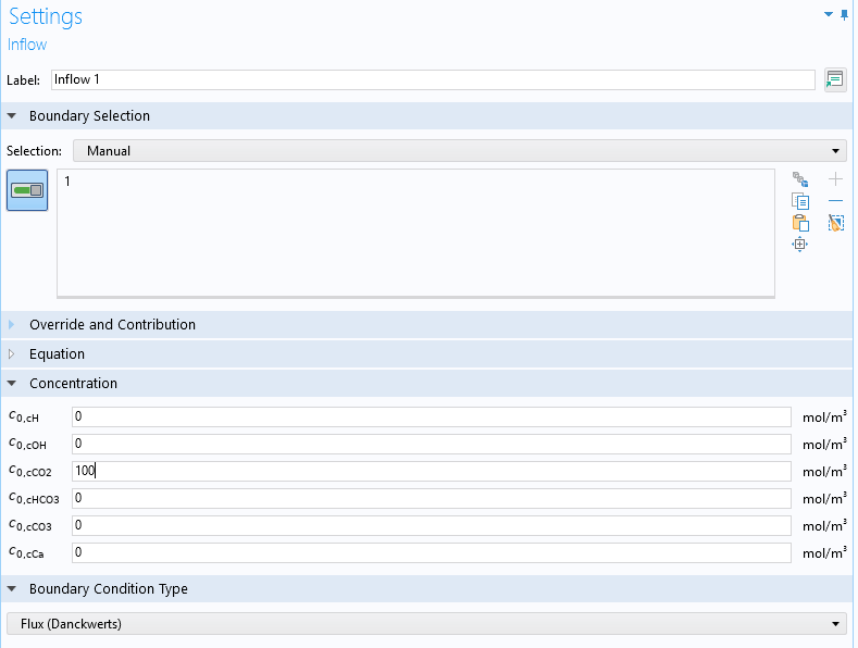

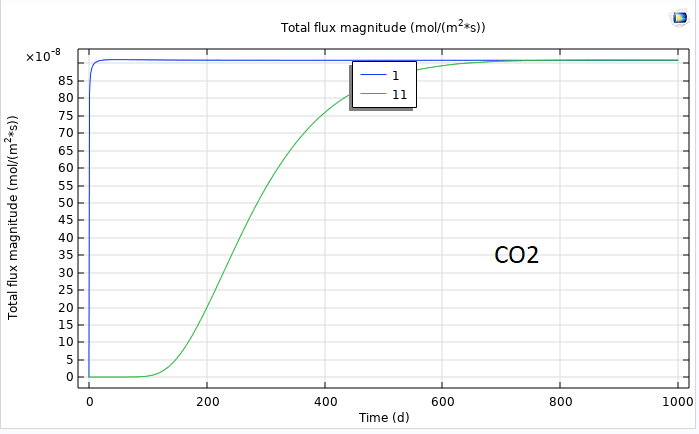

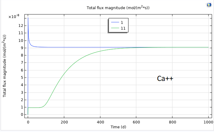

When I run the model I get satisfactory results. **The only problem is, when I check the total fluxes for different species at the inlet I get a non-zero value. In rules as I am injecting only CO2 I should not get any other inflows. **

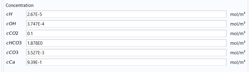

I have attached the initial values and the total fluxes for CO2 and Ca++ at the inlet. ‘Line 1’ is for inlet and ‘Line 11’ is for outlet.

Posted: 3 years ago 14 juin 2022, 12:46 UTC+2
yes the inflow of other species is zero. see the attached photo.
