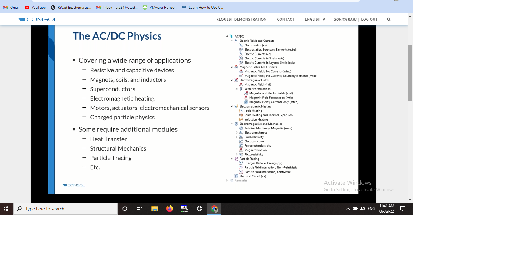

hi all I am not getting all the AC/dc physics modules. i am using 5.3a version. is it available in latest version like (5.6 version) for free or is it a paid module

"Modules" are optional add-on products that a customer can purchase for their COMSOL license.
What physics appear in the "AC/DC" folder in the Model Builder depends on which modules were purchased by your institution. Even a license for just the base package (COMSOL Multiphysics with no add-on module) will feature some physics in the "AC/DC" folder. With added modules more physics will be available.
The Specifications Chart shows what features come with which module.
To see what modules are on your license, in the COMSOL GUI, go to File > Licensed and Used Products.
