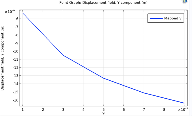

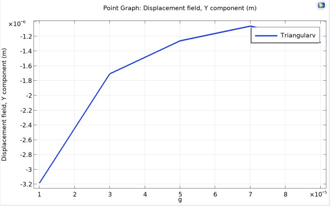

Hello, Thank you for your answer.
I did mesh refinements, still different types of meshes converge to different results.
Here I attached the file. Please take a look at the results of two different studies in which each study uses one type of mesh (Mapped or Triangular mesh).
Then the graphs show the displacement for different types of mesh which are very different.
