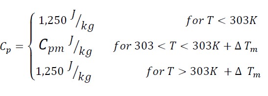

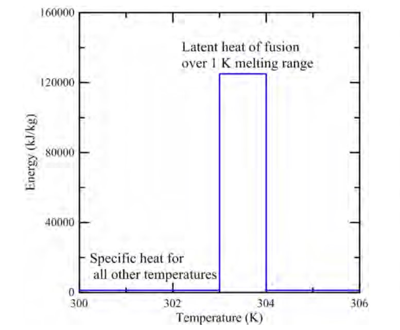

Hello I am aiming to define specific heat as function of temperature as the form given in the picture with delTa Tm = 1 K? also I uploaded a picture for the profile of Cp versus temperature? any suggestions please?
