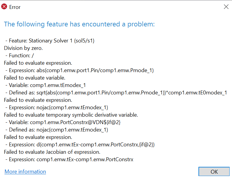

I followed your advice and was able to solve the electric field correctly both before and after the addition of the absorbing media. However, when trying to solve the heat transfer using both the Time-Dependent Study and the Frequency-Stationary Study, I received the attached error messages.
Would you please let me know which Study type I should select to get the correct dependent temperature values?
I would appreciate it if you could tell me why I got these error messages since I believe it should have come from the Frequency-Stationary feature due to selecting the Electromagnetic Heating feature within the Multiphysics branch.
All the best, Manal

  1. Add another Wave Equation node, apply to the absorbing material only
  2. Select Refractive index for Electric displacement field model for this node
  3. There was a perfect electric conductor assigned all around waveguide so field in the absorbing material was zero. Delete the second perfect electric conductor node.
  4. (reset solver to default before solving)
You should be able to verify that the electric field in the absorbing material is nonzero and that the total power dissipation emw.Qh is nonzero.
NOW you can add a Frequency-Stationary node. It must be a step after the boundary mode analysis steps.
Be aware that these multiphysics heating problems may solve very slowly with the default solvers, especially for transients. It may be necessary to mess with the solver settings.
