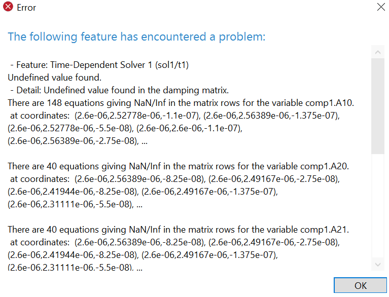

I followed your advice and have changed my simulation to be worked in the time domain (temw). I followed the steps in the Example "Transient Modeling of a Coaxial Cable" in the Application Library. However, I have got the attached error message.
Would you please tell me how I can solve this problem?
I think the problem is that in the Zref text field, I typed the below equation: (Z0_const/2/pi)*log(width of the core).
Best regards, Manal
