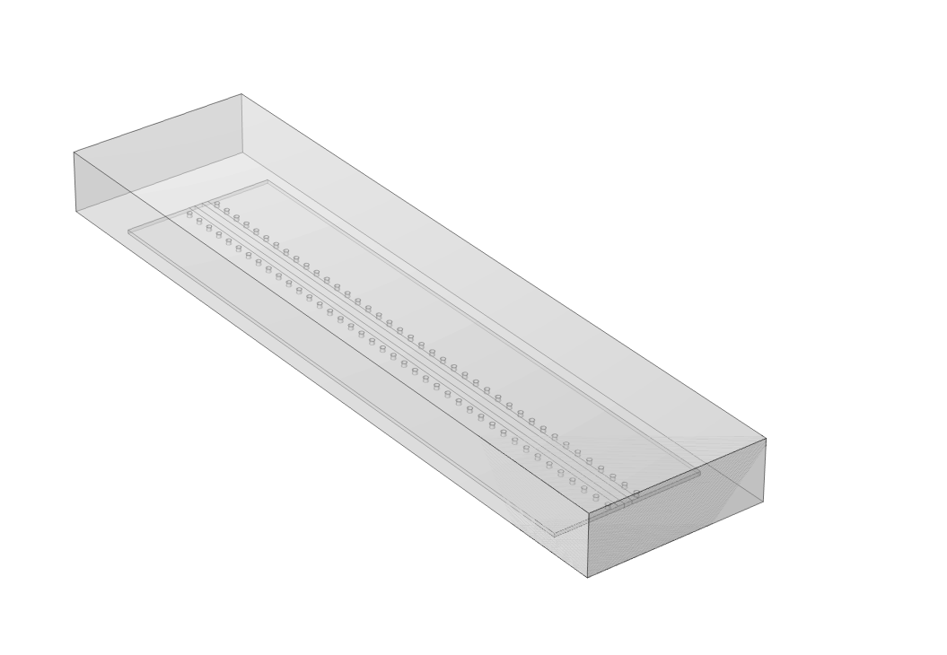

Hi! I am trying to add conductor losses to a simple coplanar waveguide model.
The model without losses (i.e. using PEC for all metals) works as expected (see attached "GCPWG_with_PEC_OK.mph").
However, when I try to replace the PEC on the signal trace with a "Transition Boundary Condition" to model conductor losses, I get the infamous error "Uniform lumped port should be placed between two conductive boundaries" on my ports (see attached "GCPWG_with_TBC_KO.mph").
I tried some suggestions I found googling (e.g. adding a domain with the trace material, so that the TBC can "attach" to it and derive its properties), but I still cannot solve this problem.

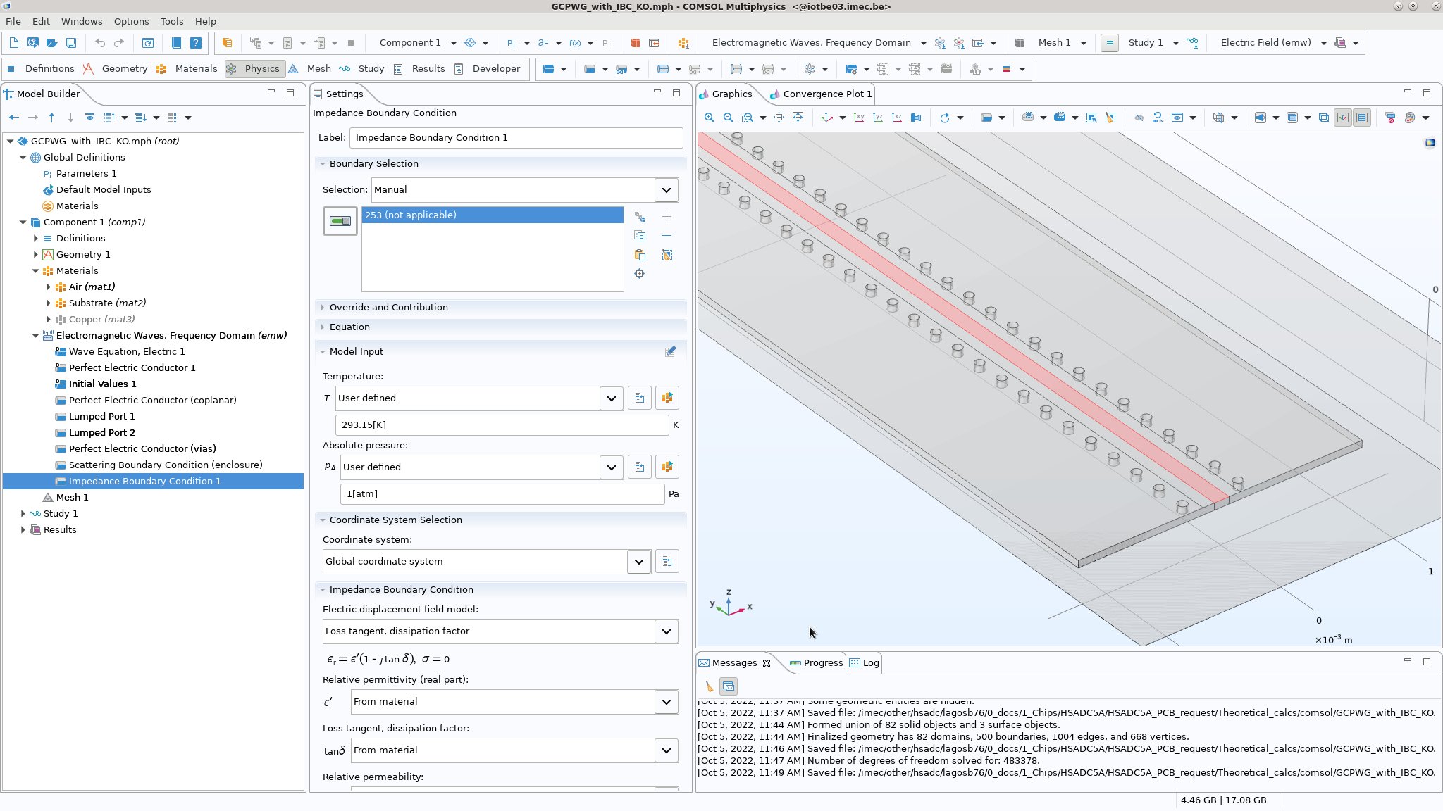

I tried to apply the impedance boundary condition to the signal trace, but I get the "not applicable" message (see attached). The model runs but from the results it's obvious the IBC it's being ignored and the conductor losses are not being modelled.
Could you please elaborate on how to apply this condition?

Jorge,
the impedance boundary only works on external boundaries and it seems your lossy boundary is an internal one. I think you only need to assign a boundary material to the respective boundary and the transition boundary should work. A domain material assignment isn't working for boundaries.

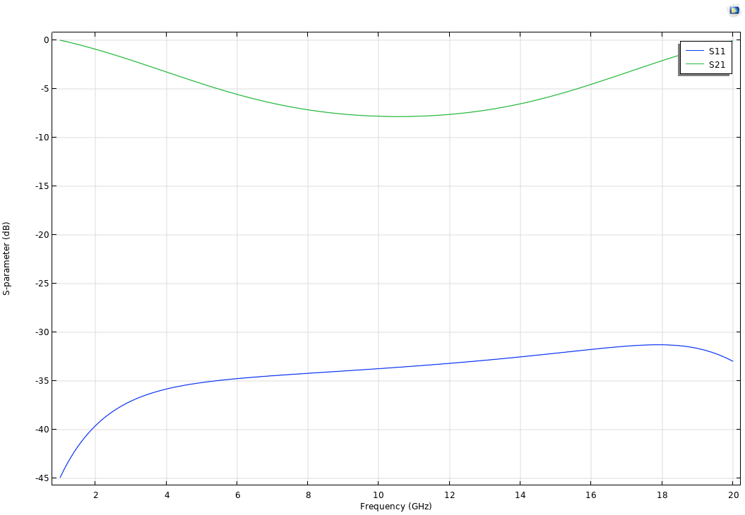

Thanks Edgard! Apparently it was indeed just a matter of properly selecting the boundaries fir the materials & TBC . The model now runs; I will go into analyzing the results to see if they make sense. Cheers, Jorge.
