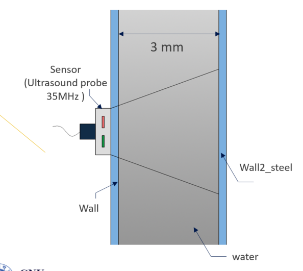

Could someone help me to make a simple acoustic model ?
I want to simulate the reflection coefficient of wall2 as attached picture.
picture:https://photos.app.goo.gl/PehecCNTTVEo8Adr9 https://photos.app.goo.gl/PehecCNTTVEo8Adr9
Thanks and Regards! Han

Dear Han Nguyen,
For modeling reflection/transmission coefficients, it is useful to apply a background pressure field as the excitation. Then, the scattered field can be separated from the incident field. You can see this example in the COMSOL gallery (https://www.comsol.com/model/acoustic-transmission-loss-through-periodic-elastic-structures-1974) for how this is done.
Mark
Dear Han Nguyen, For modeling reflection/transmission coefficients, it is useful to apply a background pressure field as the excitation. Then, the scattered field can be separated from the incident field. You can see this example in the COMSOL gallery (https://www.comsol.com/model/acoustic-transmission-loss-through-periodic-elastic-structures-1974) for how this is done. Best, Mark
