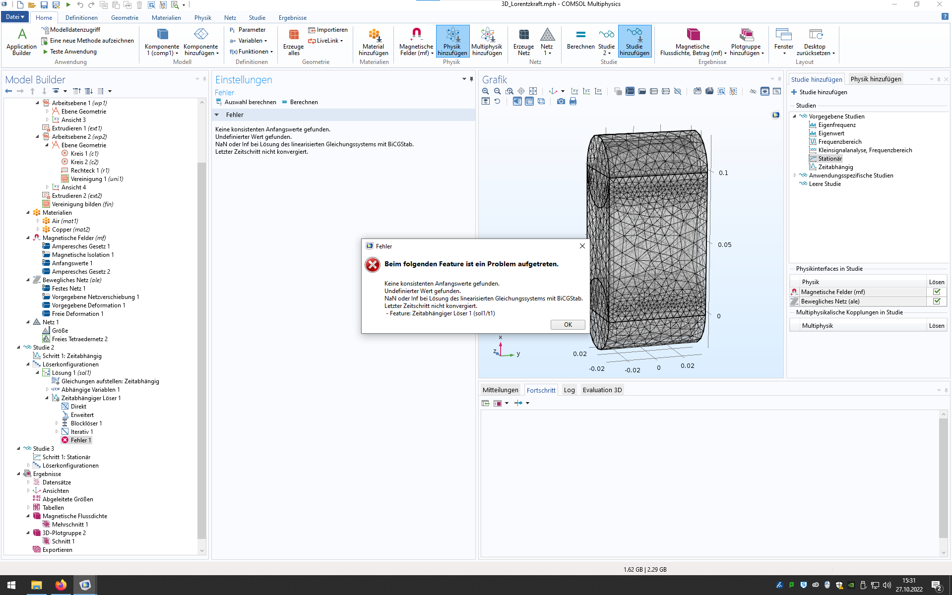

My solution until now is an ampere law with remanent flux density. I then change the B_r for y until I get 1 T in the middle of my domain. It is not perfect, but it is a solution.
As long as I use a stationary study. When I use a time depentent study, which is of course what I need when I want to move the conductor, I get the following Error (translated from german): No consistent starting values found. Undefined value found. NaN or Inf at Solution of the linearized Equation System with BiCGStab. Last time step did not converge. - Feature: Timedependent Solver 1 (sol1/t1)
So, is there a better way to create a homogeneous magnetic field? Or if not, how can I make the amperes law work in a time dependent study?

Hi Annika,
you have two (maybe more) options to create a uniform magnetic field:
  • Solve for the reduced field and enter the background field or vector potential. or
  • Apply a suitable vector potential to the outer boundaries of the modeling domain
For a time dependent study you would typically run a stationary study step before, to make sure the time dependent study starts with suitable initial values.
Cheers Edgar
