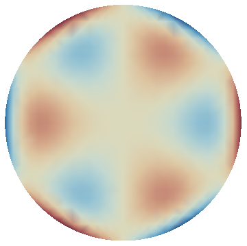

I need to optimize voltage on different places of piezoelectric actuator.
I need it according to an image (of displacements)
1) How to properly define the displacement function on the imported image? (an examle I send in the attachement)
2) Is it worth to use an optimization module as for the voltages?
If you have any experience, it will be appreciated!
Thanks a lot guys!
Katerina

for an optimisation case you can look at my drop-in on the model exchange, I do the contrary, get the Zernike polynomials from the deformed shape of a plate/mirror.
The issue for me, in your case, is to get numerical values in a x-y meshed interpoaltion from the image, but looking at the nice symmetry, you can probably also guess which mode it is and define a function rather close to that shape and use that as displacement increment. Then optimise oyur voltage to get the corresponding displacement.
You should even be able to do that without the optimisation module, but its easier with ;)
Hi for an optimisation case you can look at my drop-in on the model exchange, I do the contrary, get the Zernike polynomials from the deformed shape of a plate/mirror. The issue for me, in your case, is to get numerical values in a x-y meshed interpoaltion from the image, but looking at the nice symmetry, you can probably also guess which mode it is and define a function rather close to that shape and use that as displacement increment. Then optimise oyur voltage to get the corresponding displacement. You should even be able to do that without the optimisation module, but its easier with ;) -- Good luck Ivar
