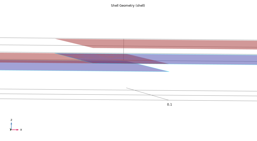

There is an easier way:
Add a Boundary to Boundary connection from Connections at the boundary level in the Shell interface.
However, when working with shells and offsets, you have to be careful about what is top and bottom. Add a Shell Geometry plot from the Add Predefined Plot window to verify.

Dear Henrik,
Thank you!
I have the Shell Geometry plot as the attached image file. I think the setting for thickness and offset are correct.

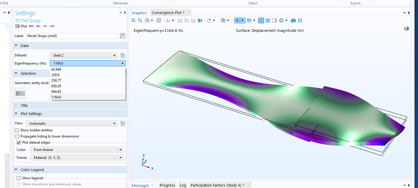

I use boundary to boundary connection suggested by Henrik. Mesh density for solid/shell model is shown in the attached picture. Eigenfrequencies for both models are in good agreement. Is the increasing discrepancy against frequency an expected outcome for using shell? The bending curvature is steeper for higher eigenfrequency for which shell approximation is degrading. Is it a proper interpation?
