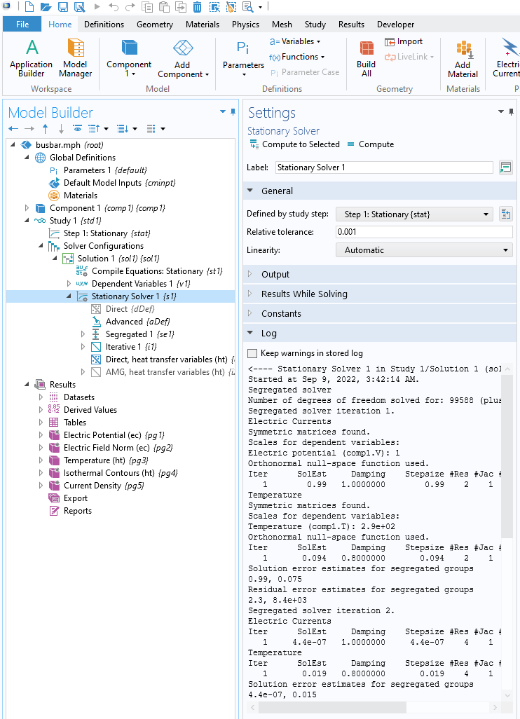

I am interested to check some parameters (like degree of freedom) of my previous simulations. The simulations are finished, saved and comsol is closed. Can I have access to the log file in this stage?

The solver log is stored in the solver feature that generated it, see the attached image.
