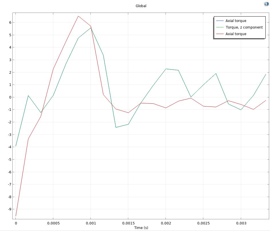

I am currently modelling a 3-phase PMSM motor in 2D in comsol. It is an outer rotor, inner stator design and everything seems to be working as expected except for the torque calculation.
Due to the motor being part of a project with an NDA agreement I can unfortunately not upload my model but I will try to explain the things I find weird with the torque results as best I can.
I am using both the Arkkio torque method and the normal force calculation. Both result in weird, and wildly different, results. The thing that bothers me the most is that I am getting non-zero torque for both torque calculation methods while supplying zero current to the coils.
The attached image is of the torque when supplying no current to the coils and rotating the rotor with 3000 rpm through a rotating mesh. The green line is the torque from the force calculation and the red line is from Arkkio.
The force calculation is defined over the domain of the rotor and half of the airgap (closest to the rotor.
The Arkkio torque domains are both halfs of the airgap, separated with a boundary pair with continuity.
Another weird effect of the torque is that the conductivity of the stator core has a big impact on it. Lowering the conductivity lowers the torque. If I choose a conductivity that is about two powers lower than the actual conductivity the torque becomes almost zero for zero current.
The entire mesh is extremely fine and with a boundary layer.
Any help would be appreciated as I have been puzzled with this torque issue for quite some time now and tried everything I could think of.

without knowing the details of your design, as this is a PMSM design with permanent magnets, shouldn't you expect some cogging torque due to the permanent field?
Cheers Edgar

I agree with you that some cogging torque should be expected. However, a mean of 9 Nm (from Arkkio) of cogging torque with no current seems to be to much for me. The motor is approximately only 100mm long with a radius of 40 mm.

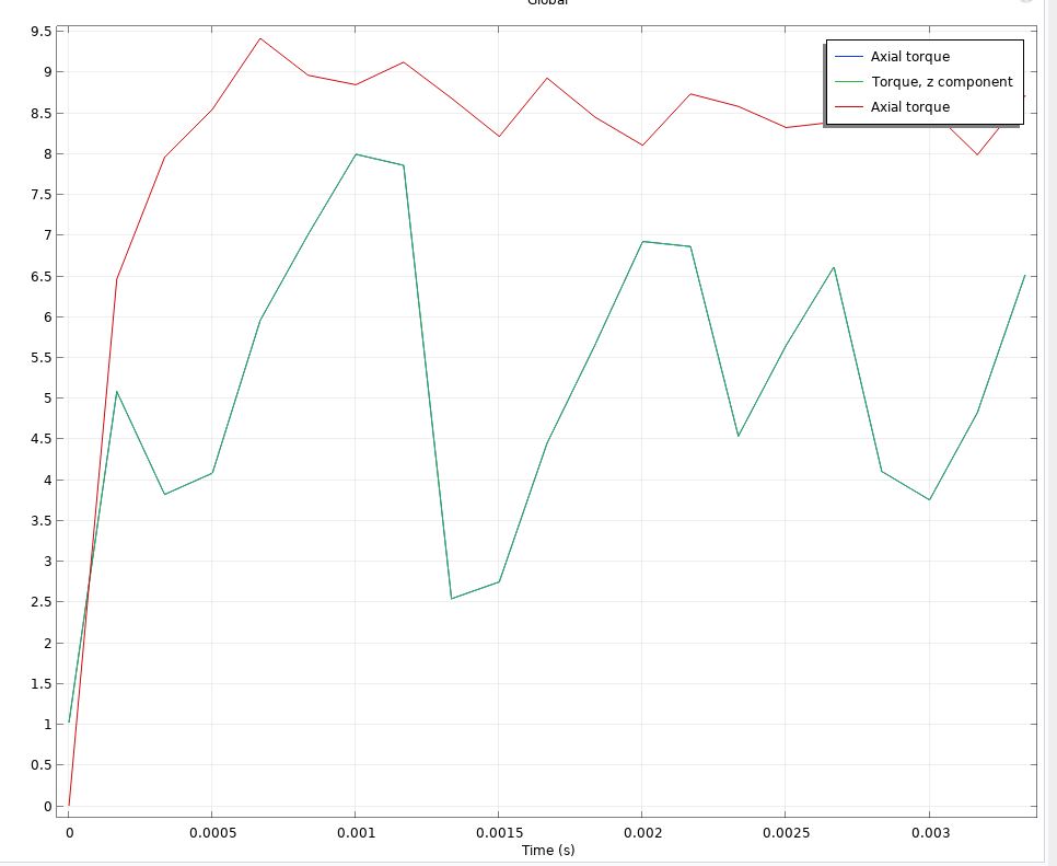

If I apply a sinosoidal 3-phase curent to the coils I get a reduction in Torque, compared to the zero-current case.
Attached is the torque results for a run with 100A peak current supplied. This run is also at 3000 RPM.
Could you think of anything that I could have done wrong or missed while building the model that would result in such results? I know that it is very hard to answer without seeing the model.
Best Regards, Fredrik

As the curve looks rather erratic, is your time stepping fine enough to resolve the expected torque curves?

Even with finer time stepping I got the same result. However, I think I found a solution to my problem. I found this guide:
https://www.comsol.com/blogs/how-to-analyze-an-induction-motor-a-team-benchmark-model
In which the stator core is given a conductivity of 0 S/m as the core is laminated (and therefore electrically insulated I assume).
If I assign zero conductivity to the stator core in my model the torque starts to behave as expected. Zero current gives almost Zero torque with a little bit of cogging torque. And torque is mostly only influenced by the supplied currrent.
Have I understood it correctly that this is the way to "tell" comsol that the stator core is insulated from the windings?
The Arkkio torque is the one now producing expected results. But the force calculation for torque is not. It feels like they should be giving similar results if the model was working properly.
Even with finer time stepping I got the same result. However, I think I found a solution to my problem. I found this guide: https://www.comsol.com/blogs/how-to-analyze-an-induction-motor-a-team-benchmark-model In which the stator core is given a conductivity of 0 S/m as the core is laminated (and therefore electrically insulated I assume). If I assign zero conductivity to the stator core in my model the torque starts to behave as expected. Zero current gives almost Zero torque with a little bit of cogging torque. And torque is mostly only influenced by the supplied currrent. Have I understood it correctly that this is the way to "tell" comsol that the stator core is insulated from the windings? The Arkkio torque is the one now producing expected results. But the force calculation for torque is not. It feels like they should be giving similar results if the model was working properly.
Posted: 3 years ago 22 nov. 2022, 03:29 UTC−5
The lamination prevents eddy currents and thus losses in the core and the low conductivity has a similar effect. The eddy currents (which result from the permanent field, even with zero coil current) produce a damping effect and this is probably what you saw in your model. Regarding the force calculation, it is very mesh dependent. You need to take care particularly in the air gap. I would recommend to do a mesh convergence study.
