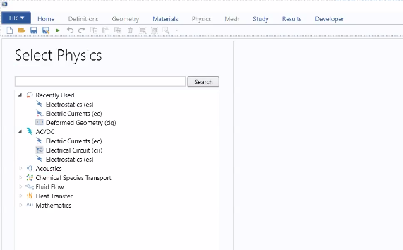

Can't find Electrochemistry in Physics tree of 1D model wizard
Mohammad Aftab Uzzaman
Please see the attached picture and help me to find out the Electrochemistry physics of 1D model wizard. My COMSOL version is 5.3

Hi Mohammad,
The most likely cause is that the COMSOL license that you are using does not include any modules for electrochemistry. Also, the version you are using is quite old, so you would benefit from upgrading to a newer version (6.1 is the current version).
Magnus
Hi Mohammad, The most likely cause is that the COMSOL license that you are using does not include any modules for electrochemistry. Also, the version you are using is quite old, so you would benefit from upgrading to a newer version (6.1 is the current version). Best regards, Magnus
