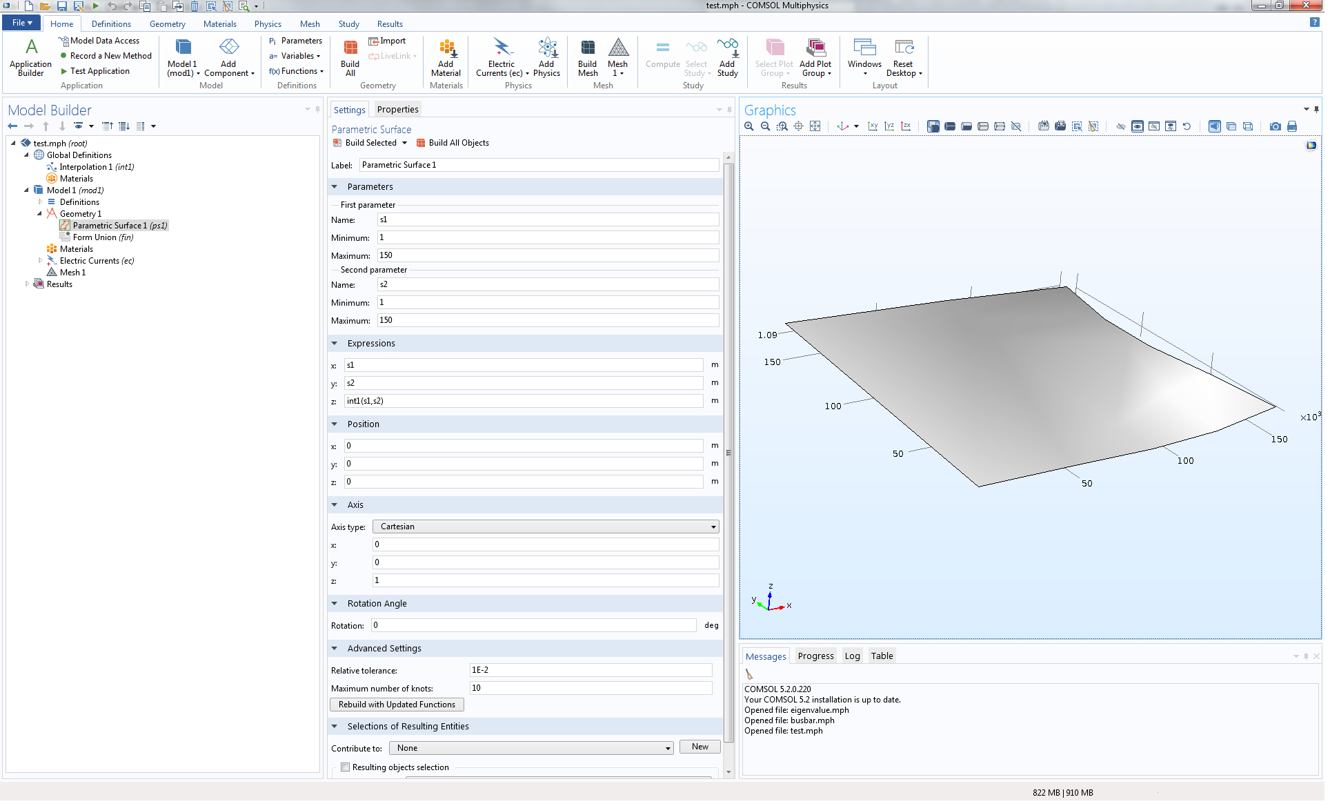

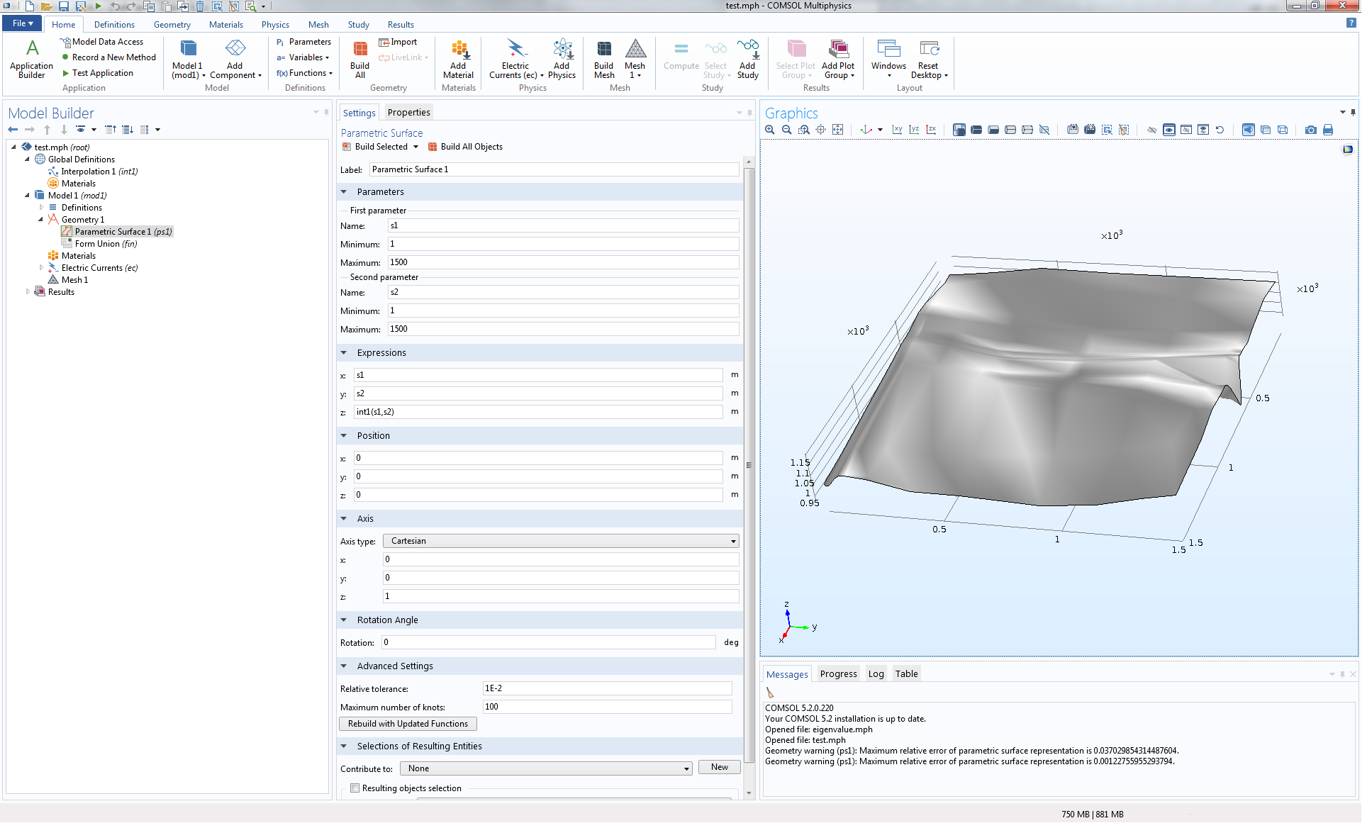

Hi again,
Sorry, I don't have 4.2 any more.
Attached is the screenshot after I increased the ranges for s1 and s2 to 1500. You'll notice that I increased the number of knots from 10 to 100 to capture your elevation data better.
Hi again, Sorry, I don't have 4.2 any more. Attached is the screenshot after I increased the ranges for s1 and s2 to 1500. You'll notice that I increased the number of knots from 10 to 100 to capture your elevation data better. Best, Jeff
