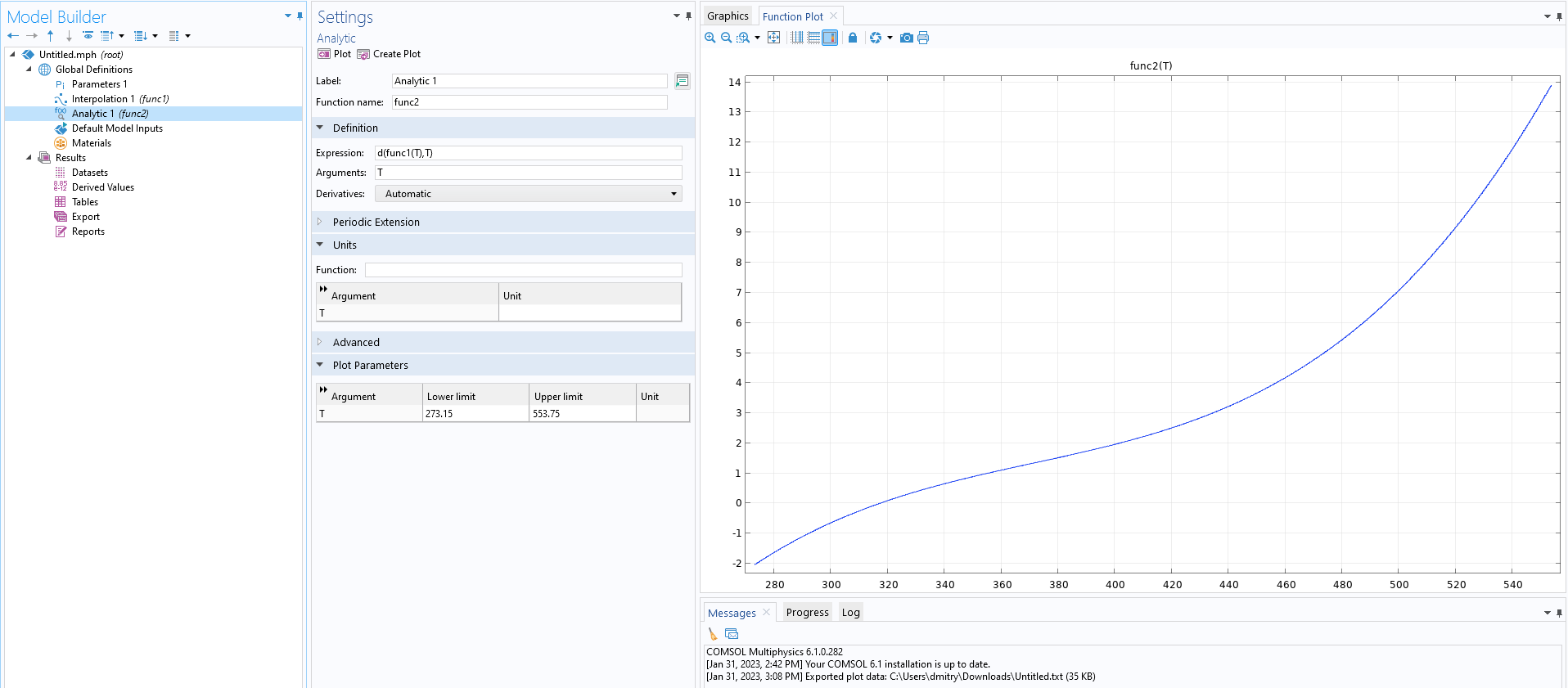

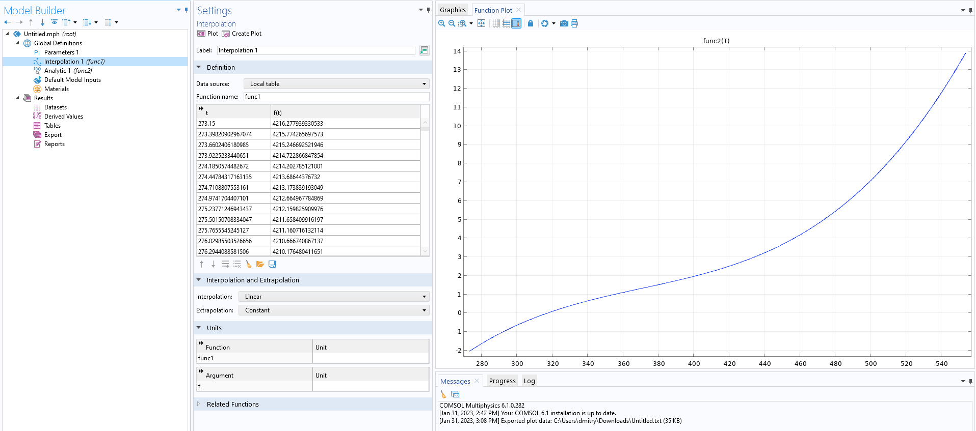

Sure. To demostrate this I've created Interpolation function func1(T) (see Screenshot_1.png) and Analytic function func2(T) = d(func1(T),T) (see Screenshot_2.png). As you can see the diffirentiation operator works.

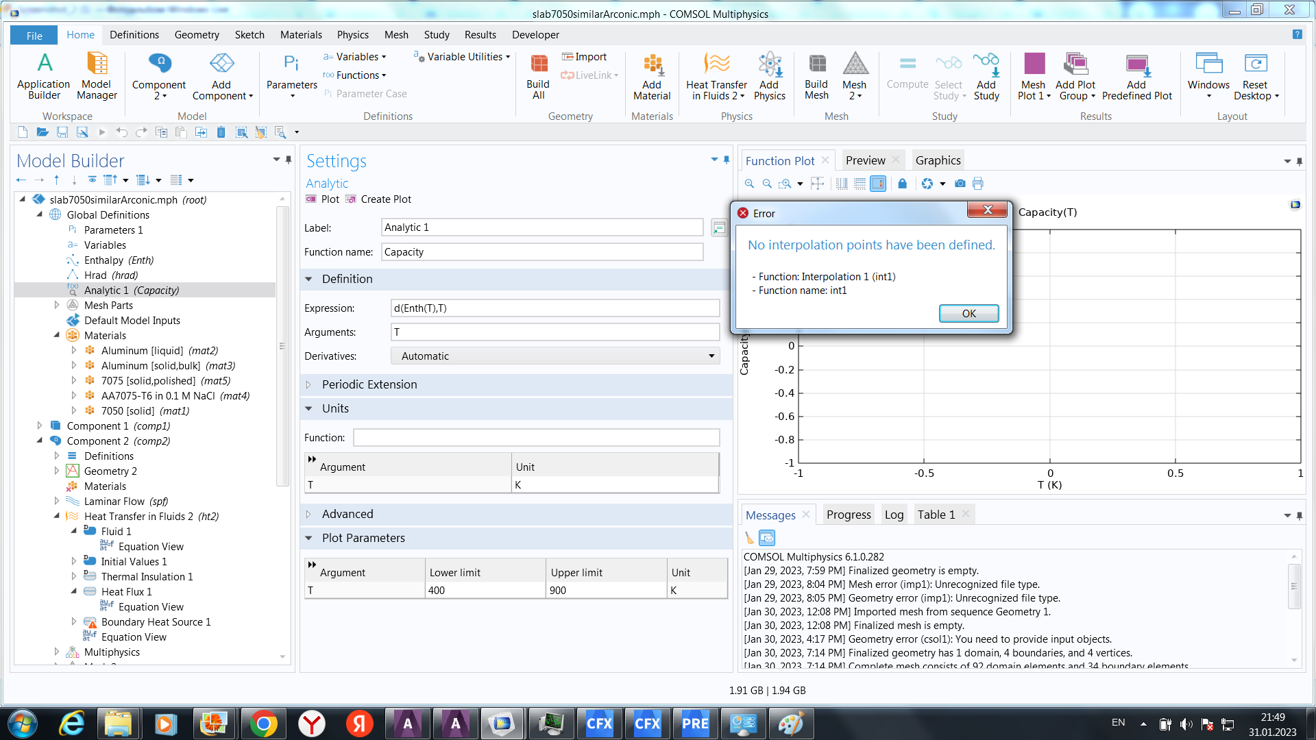

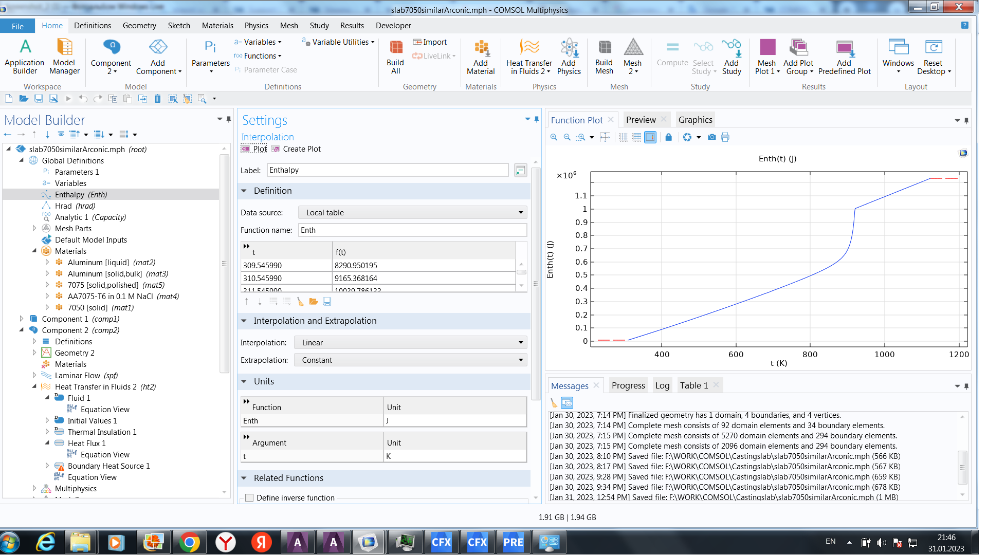

1.I have cheked the d(Enth(T),T) on your manner, but can't to recive normal derivative function. Please see the my prinscreens, the results is negative for both cases - when i input the unit dimensions - J, K for Argument and Function fields and without it (similar to your example). Please check, maybe i have a too much points in initial Enthalpy .txt file and remove for this first 5 row.
