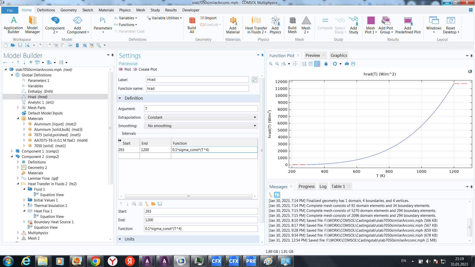

I see the big possibilities for using Expression and Function for flexible define BC, matherial properties and etc, but with my huge expirience i have strange problem for my works with Espression in the Comsol. For example i want to define Piecewise function for radiative emisivity BC for walls, and i define hrad function with argument T is 0.1*sigma_const*(T^4 - 293^4) and interval for T. But Comsol not calculated the part of expression "-293^4" and results the same for "-293[K]^4" and etc, for example 0.1*sigma_const*(T^4)- 0.1*sigma_const*(293^4). The plot graph for this function calculated only for T argement and absolutely ignored all other. Where i can see the principles (algorithm) for correct defining of expresions? Please help me. As well, becasue Expression field absolutely don't has contects help (For example Ansys CFX preprocessor has a prefect help for all variables and etc in the field for formula), I'm as a user not understand what i may to do in the Expression field. The help of Comsol in laptop version is too small and i want to find the all list of operations, variables and etc (include from results solutions) which i can to use in the expression field. Please help me. Give me please the links to webinars,papers and other Comsol web helps, where i can see it clear.

You can see on the screenshot (Screenshot_1.png) that Peicewise function works correctly.

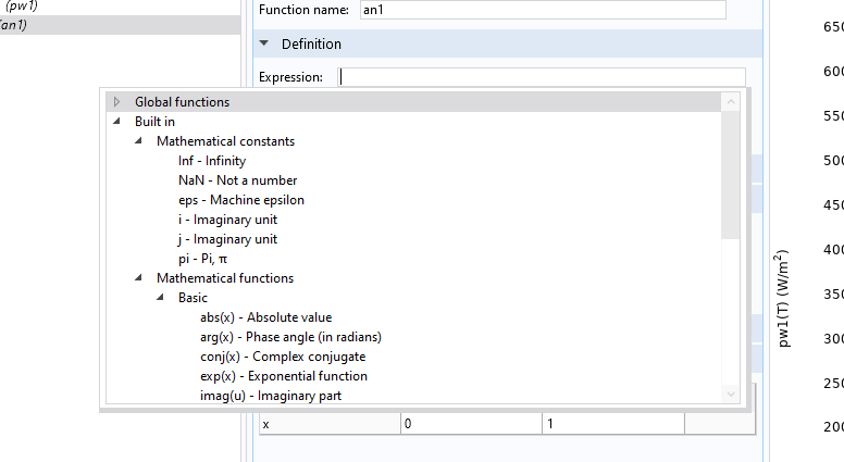

It's not exactly the case. With CTRL+Space shortcut you can open the list of parameters, variables, functions and operators that you can use in Expressions (see the Screenshot_2.png).

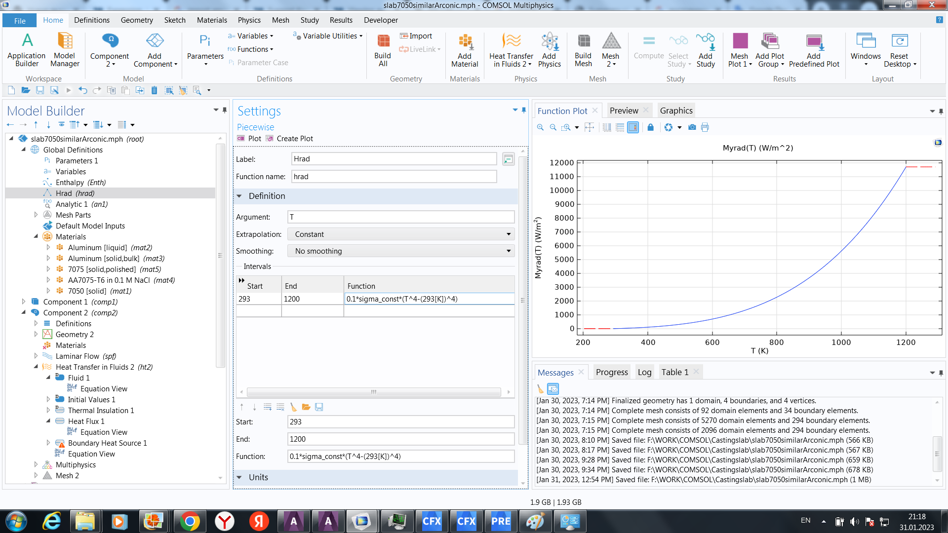

Thank you for you quick reply 1. Yes, context help is working by CTRL+SHIFT, but only for Expression field not for Function. 2. Please see the results of calculation fuction on my laptop... The both function gives a equal results. It is too strange, may be it my error and i'm a stupid. 3. Please help me and show (give) the direct link to paragraphs in your link ( https://doc.comsol.com/6.1/docserver/#!/com.comsol.help.comsol/helpdesk/helpdesk.html), where i can find the complete list of all variables, operators and etc which i can to implement in Expression and Function field.

In the "with" screenshot, the plot is of a function called Myrad, not hrad. Could that be the issue?

"Myrad" it was previous function name before correction. I have change the name and at any case results the same - not correct. After your message i repeated few time to calculate - negave. I'm confused, the my version of Comsol is last - 6.1.0.282. This is a error of system i think, because the d(Enth(T),T) not working as well (my other forum topic). I'll thinking...

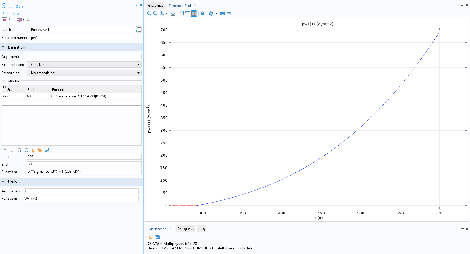

If I change the function definition to include 293[K] in the piecewise function and click the Plot button, the values of the plotted function change as expected in the Function Plot window. I cannot really see any other reason than that you have not updated the function plot.

Hello Magnus Please see the record of screen. I'm reinstall the COMSOL 6.1.0.282, but the result the same. This is a system bag i think

I see the plot change, albeit subtly, at 0:40 in your video.
Note that T^4-293^4 is not very different from T^4 when T>300 (T^4 grows very quickly and dominates 293^4). When T<300, the 0.1*sigma_const multiplying factor causes both expressions you're plotting to be essentially zero and therefore visually indistinguishable.

It is correct. The values is too big and "covered" the small "-293^4" addition. This issue is closed "d" operator not working on Win7, and I'm update to Win 10. Now all working.
