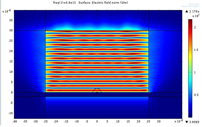

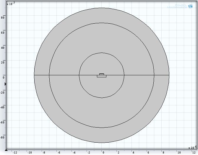

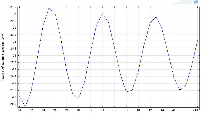

I'm trying to calculate the radiated and absorbed powers of an isolated patch antenna.
I create a box with 4 PML. When i change the horizontal dimension of my box, the calculated powers vary significantly, even if the box size is large compare to the antenna size. There is some horizontal interferences that we can see on the field map, or on the calculated power.
I tryied different configuration: size box, mesh, pml, source... but I still have this undesirable variation.
If anyone have an idea.
Thanks.
(the mph file with the results is too big, so I delete the solution to attach it to the discussion. The jpg file shows the absorbed power in the metal near the antenna vs the horizontal size of the box, we can clearly see the undesirable oscillation)
