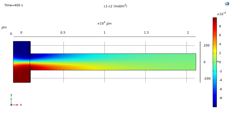

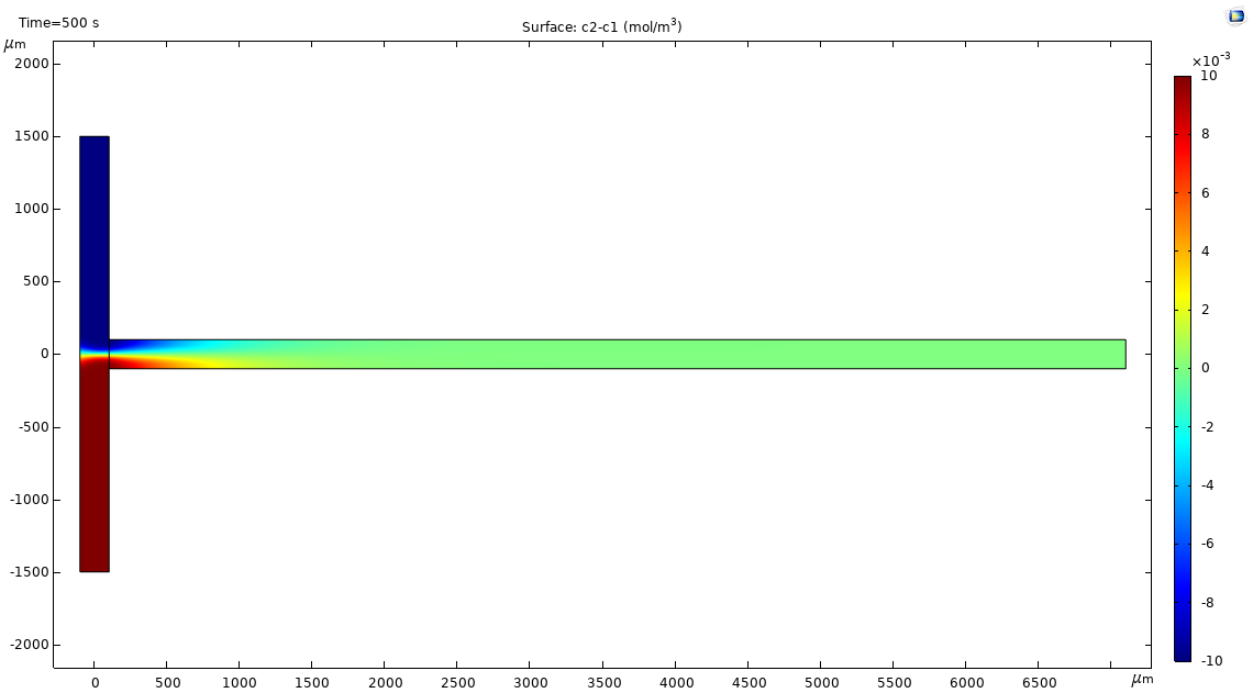

I need help in a 2d vs 3d model. i am simulating a microchannel and using the microfluidic module. I use the transport of diluted species to see the concetntration profile. I use both 2d and 3d simulations. When i do the 2d vs 3d i see the concentration profiles are virtually similar. In 2d you dont put the height of the channel, does comsol assume any 2d model and does the simulation assuming its in 3d space and makes a 3d profile? 1st image is 2d and other two are 3d

Hello Bhuvan,
A 2D model assumes that there is no dependency of the inputs and outputs with the third direction.
A 3D model solves for the full 3D equations, without making any such assumption. But if your inputs to a 3D model are independent of the third dicrection then it is entirely possible, even likely, that the solution will be independent of the third direction.
Hello Bhuvan, A 2D model assumes that there is no dependency of the inputs and outputs with the third direction. A 3D model solves for the full 3D equations, without making any such assumption. But if your inputs to a 3D model are independent of the third dicrection then it is entirely possible, even likely, that the solution will be independent of the third direction. Jeff
