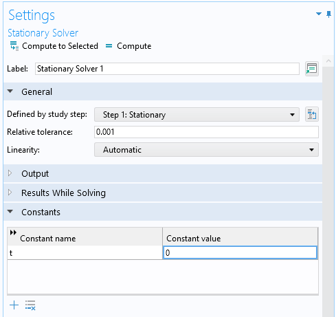

                                                    Magnus, I'm not sure how to implement this. Can you post a sample .mph or a screenshot showing the setup?

Hi Sean,
If you have an expression with "t" somewhere in your model and want to solve it using a stationary solver, you can then simply add a parameter or constant  t and give it a value, such as 0. You can use a Parameters node, or you can define it as a constant in the Stationary Solver settings (see the attached screenshot).
Magnus
