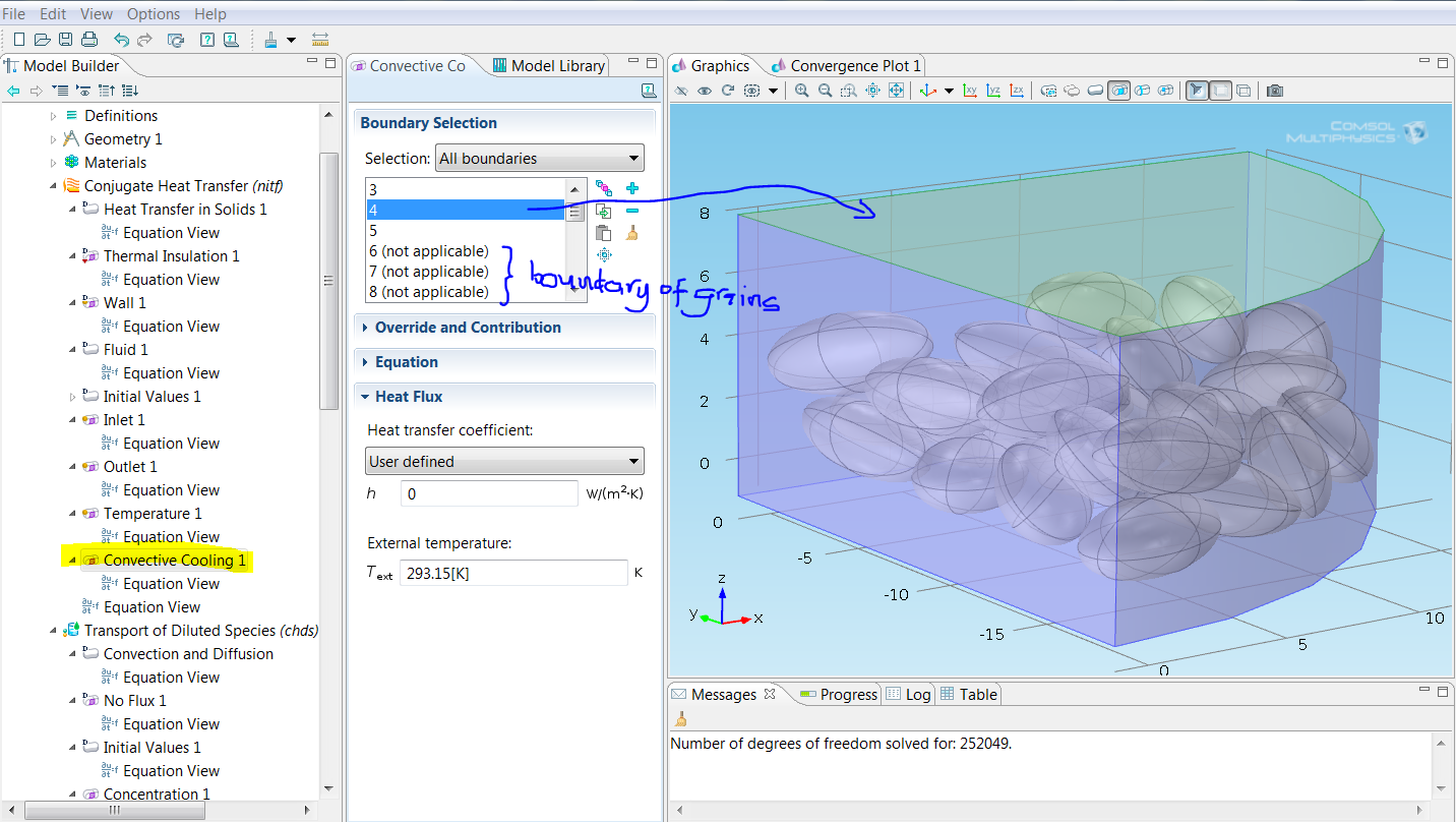

Dear Dr. Elabbasi,
I am doing a simulation on the heat ans mass transfer in some grains using both the conjugate heat transfer in solids (nitf) and transport of diluted species (chds). The simulation for the heat transfer is quiet good but the not in the mass transport. Maybe there are some issues on the type of mesh that I am using. Anyway, I'll just leave it at that for the moment.
What I would like to inquire right now is the problem on the heat loss due to evaporation. The passing of the heat air to the surface of the solid boundary caused heat and mass transfer at the same time resulting to some degree of heat loss. Does the nitf node of COMSOL account for this loss?
Because I want to consider the heat loss, I tried adding the convective cooling. However, I am having some problems because the boundaries of the grains are inactive (Attached picture). Am I doing it correctly? Is there any other way to do this so that the heat loss can be included in the analysis?
Thank you very much in advance.
Beat regards,
Jonathan Perez
