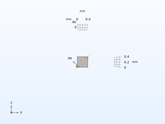

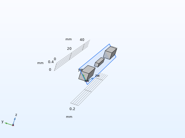

You can achieve this by drawing a cross section (here, a square) in a work plane and then using an extrusion with scales, as shown in the attached files.
Hello Ibrahim, You can achieve this by drawing a cross section (here, a square) in a work plane and then using an extrusion with scales, as shown in the attached files. Best, Jeff
