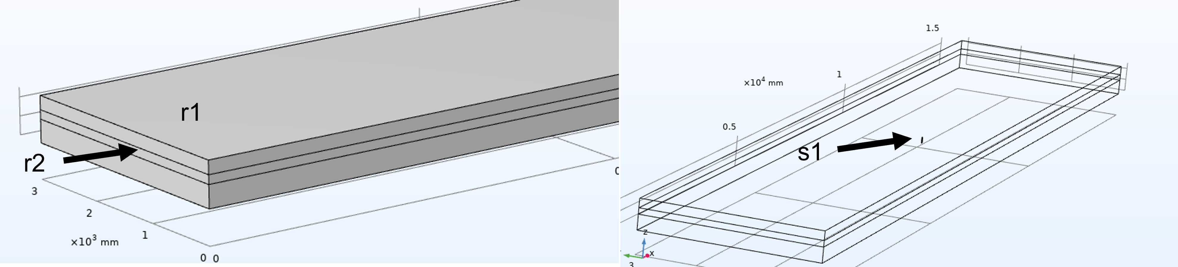

I have a model consisting of 3 components. The geometry is a rectangular structure (r1) where a laminar flow flows. Inside the r1, I would like have another rectangle (r2) with size width and length but half the thickness. r2 suppose to be a non-newtonian viscoelastic fluid. Under r2 I have solid structures (s1). I would like to see how the flow in r1 effects s1 while r2 is in between. Basically, the transfer of shear to the s2 caused by r1 flow.
I tried to have two laminar flows for r1 and r2 and structural mechanics for s1. However, I am not sure how accurate this is and I could not form a connection between the two laminar flows. Any suggestions for how I could improve this model will be most welcome.
