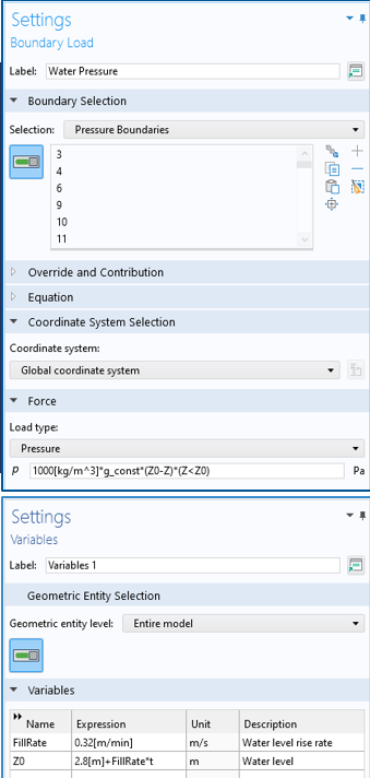

Attached is an example where the water level is even rising with time.
