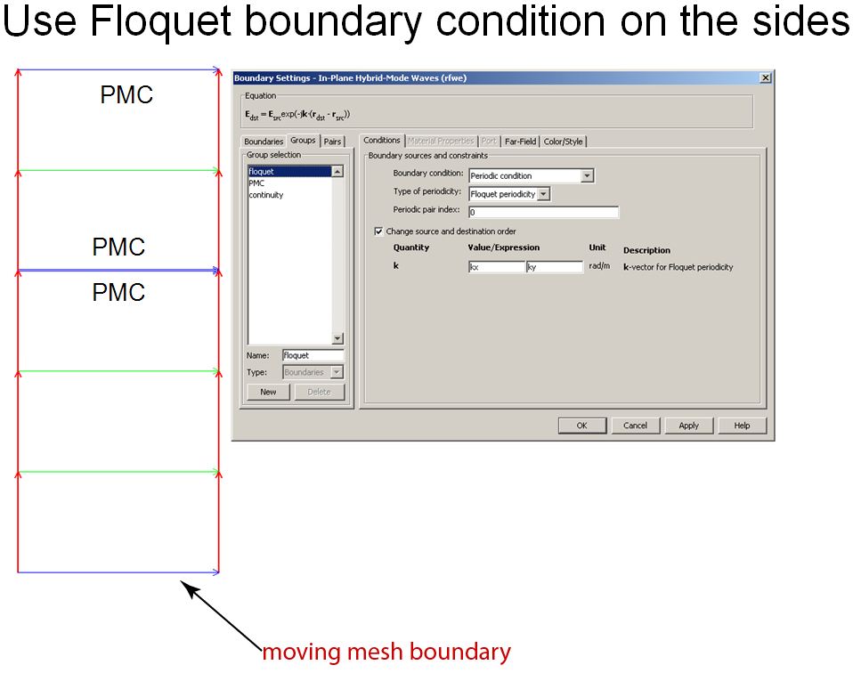

If I use another BC instead of Floquet periodicity, PEC BC for instance, the model runs without problem. But I really need to include Floquet periodicity, PEC BC works well only for normal incidence in my geometry.
Does anybody know how to combine Floquet periodicity and moving mesh (ALE)?
I attached a sketch of the geometry.
Thanks to anyone in advance!
