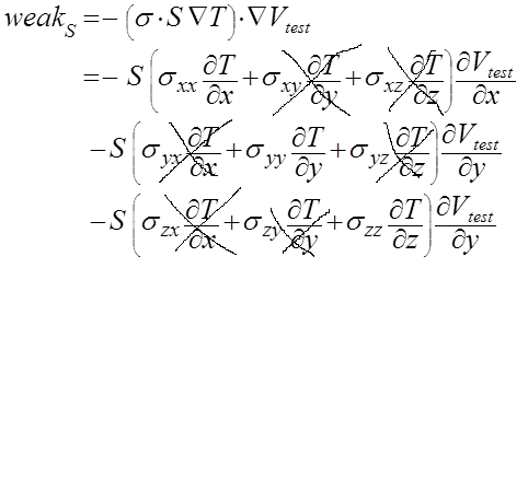

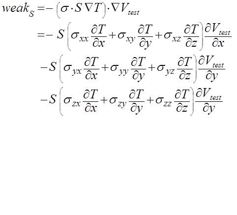

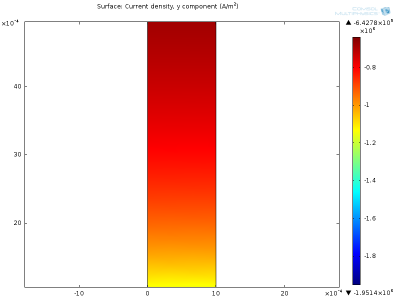

Dear Sergei, have you tried plotting the current distribution? I think you will find the results interesting. I have attached a figure of the current distribution of the Jaegel/comsol guide thermoleg simulated with your physics.
I'm interested in how one should choose testfunctions for the weak equations in one physics interface with dependent variables. Using the method with weak contributions the one in the heat transfer interface tests for its own variable T and in electric currents use V. But in the physics guide I cant find any reason for that one variable should test one and not the other weak equation.
q·test(∇T)+Q·test(T)
-J·test(∇V)
Why not:
q·test(∇V)+Q·test(V)
-J·test(∇T)
The same goes for boundary conditions
qin*test(T)
Jin*test(V)
Dear Sergei, have you tried plotting the current distribution? I think you will find the results interesting. I have attached a figure of the current distribution of the Jaegel/comsol guide thermoleg simulated with your physics. I'm interested in how one should choose testfunctions for the weak equations in one physics interface with dependent variables. Using the method with weak contributions the one in the heat transfer interface tests for its own variable T and in electric currents use V. But in the physics guide I cant find any reason for that one variable should test one and not the other weak equation. q·test(∇T)+Q·test(T) -J·test(∇V) Why not: q·test(∇V)+Q·test(V) -J·test(∇T) The same goes for boundary conditions qin*test(T) Jin*test(V)
Posted: 1 decade ago 2 oct. 2013, 20:30 UTC+2
Jonatan,
Attached contains derivation of the thermoelectric weak contributions. Hopefully, this will answer your question.
Sergei
Jonatan, Attached contains derivation of the thermoelectric weak contributions. Hopefully, this will answer your question. Regards, Sergei

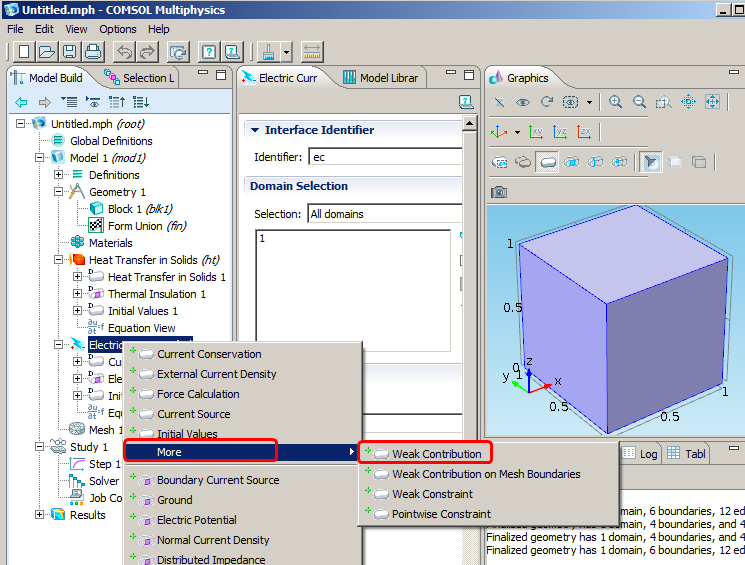

Posted: 1 decade ago 9 oct. 2013, 17:18 UTC+2
Ying,
To add ‘weak equation’ under the Electric Current node:
Right-click Electric Currents (ec) node and select More>Weak Contribution under domain features list (top section above the line)
Sergei
Ying, To add ‘weak equation’ under the Electric Current node: Right-click Electric Currents (ec) node and select More>Weak Contribution under domain features list (top section above the line) Regards, Sergei
Posted: 1 decade ago 9 oct. 2013, 20:38 UTC+2
Dear Sergei,
It seems that there is no 'more' option when a 3D domain is used. Is there any other way to add the weak equations?
Thank you!
Ying
Dear Sergei, It seems that there is no 'more' option when a 3D domain is used. Is there any other way to add the weak equations? Thank you! Ying

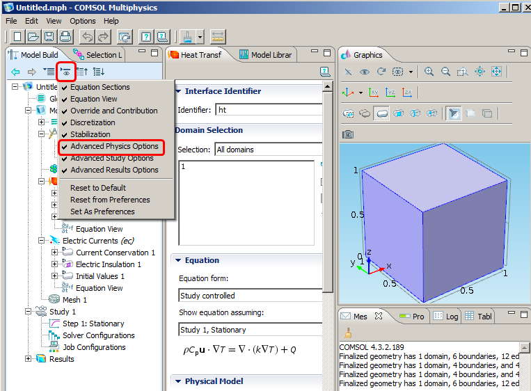

Posted: 1 decade ago 9 oct. 2013, 22:19 UTC+2
Ying,
To see "More/Weak Contribution" you have to activate “Advanced Physics Options” under “Show” button – see attached images.
Sergei
Ying, To see "More/Weak Contribution" you have to activate “Advanced Physics Options” under “Show” button – see attached images. Regards, Sergei
Posted: 1 decade ago 9 oct. 2013, 22:28 UTC+2
Dear Sergei,
Thank you very much! It's working now :D
Ying
Dear Sergei, Thank you very much! It's working now :D Ying

Dario,
Seebeck weak contribution is placed for current balance, "emdc" interface, in your case.
This term is shown in the attached image.
There are couple issues with your weak contribution expression:
1. According to Comsol sign convention, Seebeck weak term should be with “minus” sign.
2. Seems you are modeling material with isotropic electric conductivity: sigma_xx=sigma_yy=sigma_zz=sigma. Then, all off-diagonal terms for electric conductivity should be zero. Yet, those terms (containing sigma_xy, sigma_xz, etc.) are non-zero in your expression.
Sergei

Posted: 1 decade ago 28 oct. 2013, 18:27 UTC+1
Thank you,
Yes I'm making the assumption that it is isotropic. So the right equation should simply be the one in the attached file?
Thank you, Yes I'm making the assumption that it is isotropic. So the right equation should simply be the one in the attached file?
Posted: 1 decade ago 28 oct. 2013, 18:40 UTC+1
ok it works perfectly now
forgive me for my ingenuity
ok it works perfectly now forgive me for my ingenuity
Posted: 1 decade ago 28 oct. 2013, 18:44 UTC+1
Dario,
Yes, this is the right equation. (Please correct my typo for the very last factor d(Vtest)/dy->d(Vtest/dz).
Sergei
Dario, Yes, this is the right equation. (Please correct my typo for the very last factor d(Vtest)/dy->d(Vtest/dz). Regards, Sergei

Dear Sergei,
I have a question for the peltier test model: So you will get T and V for the result. How can I get the current (I) in the p and n legs to calculate the power?
Thanks a lot!
Junce
Dear Sergei, I have a question for the peltier test model: So you will get T and V for the result. How can I get the current (I) in the p and n legs to calculate the power? Thanks a lot! Junce
Posted: 1 decade ago 17 avr. 2014, 22:03 UTC+2
Dear Jonatan,
How did you get the current density? Now what I have is voltage but I need current density to calculate the power generation.
Thanks!
Junce
Dear Jonatan, How did you get the current density? Now what I have is voltage but I need current density to calculate the power generation. Thanks! Junce
Posted: 1 decade ago 18 avr. 2014, 16:40 UTC+2
Are you using the physics builder guide method?
To meassure at boundrary, create a boundrary probe and use the insert or replace button in the expression section and find your identifier.Jx Jy or Jz from the drop down tree, choose your used physics then current density. To get current, change the type in the probe setting section to Integral. I write the expressions in variables with aproriate names then export the results to tables through global variable probes to get tables with nice headers.
Are you using the physics builder guide method? To meassure at boundrary, create a boundrary probe and use the insert or replace button in the expression section and find your identifier.Jx Jy or Jz from the drop down tree, choose your used physics then current density. To get current, change the type in the probe setting section to Integral. I write the expressions in variables with aproriate names then export the results to tables through global variable probes to get tables with nice headers.
Posted: 1 decade ago 26 avr. 2014, 02:22 UTC+2
Hi Jonatan,
Thanks for answering the question. I was using the example model, just combined T and V. But now I'm trying to build up the physics builder. But the guide is for 4.3 and I'm using 4.3b. There are several difference and it's not working. Could you share your physics builder file?
Thanks a lot.
Junce
