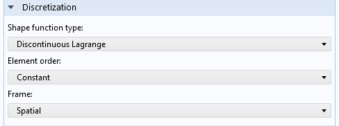

The value of the field described by this shape function is constant over each element. One effect is that it cannot be differentiated, since its gradient is zero.
Hi Henrik. Thanks for the explanation.
It is a surface evolution model, and z coordinate is the field to be solved with respect to time and (x,y) coordinates. After some run time, the geometry is still curved; it was initially an intact sphere and it is now a deformed sphere. How a smooth curved shape is possible using a constant shape function? Can you explain this more?
And, does constant shape function have the ability to capture the numerical solution accurately?
Thank you in advance for your help.
