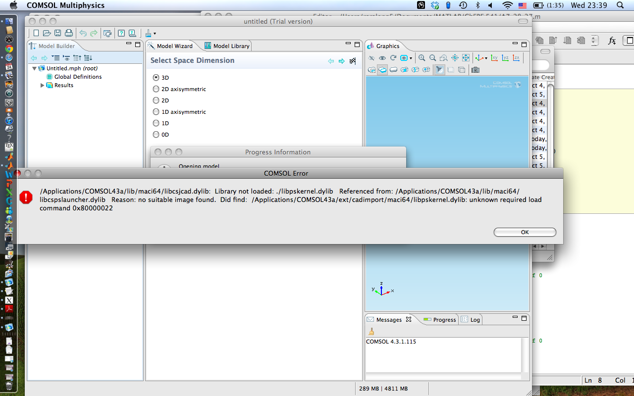

                                                    The graphics screen is displayed in black color only.
whenever i open any model, the program turns off.

                                                    I have the same problem. I am a new user of COMSOL and recently installed COMSOL 5.2.  I have a black screen on the Graphics page. Cannot draw anything. Can anyone help me on this.
OS: Windows 7 Enterprise
64 bit OS, IT, 32GB RAM
                                                                                                                                                    COMSOL Employee
                                                Posted:
                                9 years ago
                                3 janv. 2017, 16:39 UTC−5
                                                    Hello Srikanth,
Sounds like a typical graphics card problem. Please see the Support Knowledge Base for the solution:
www.comsol.com/support/knowledgebase/933/
                            Hello Srikanth,
Sounds like a typical graphics card problem. Please see the Support Knowledge Base for the solution: https://www.comsol.com/support/knowledgebase/933/
