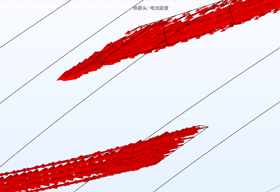

                                                    This is an elegant model, but you do have a problem with it.  It appears that the problematic region is the two wires (coil 9 and coil 19) that start and end on the same surface, rather than cross through the cylinder from one side to the other.  I strongly encourage you to focus your attention and thinking on how your detailed choices of boundary conditions work (or in this case, fail) for those specific two wires.  You may need to do a more detailed specification of the boundary conditions, to account for those two special-case wires.

                                                    Thank you for your suggestion. I don't know what the principle of the coil geometry analysis is, and perhaps this is where the problem lies? In the Opera3D software, there are models for 8-node conductors and 20-node conductors. I don't know what the corresponding models are in Comsol.
