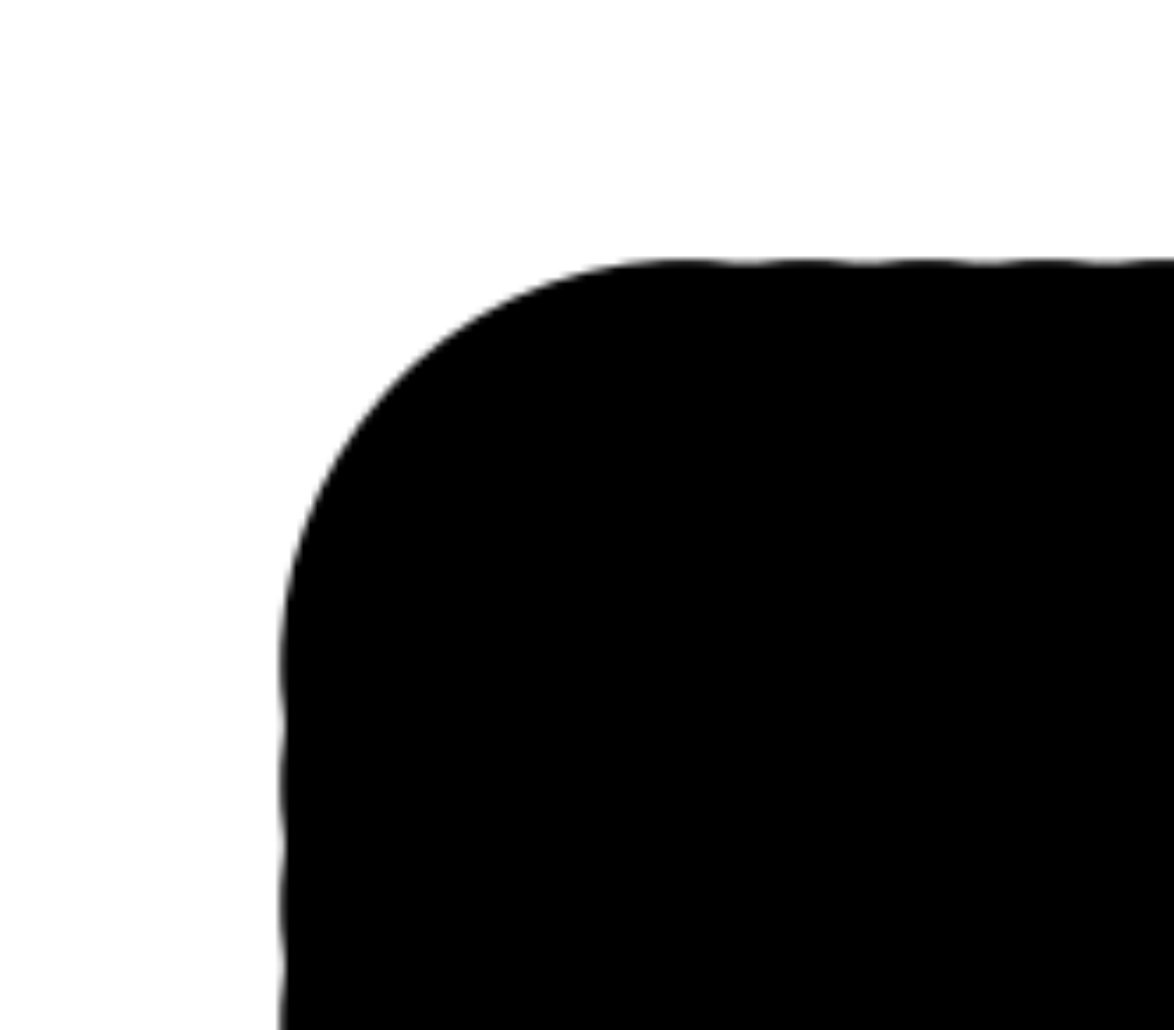

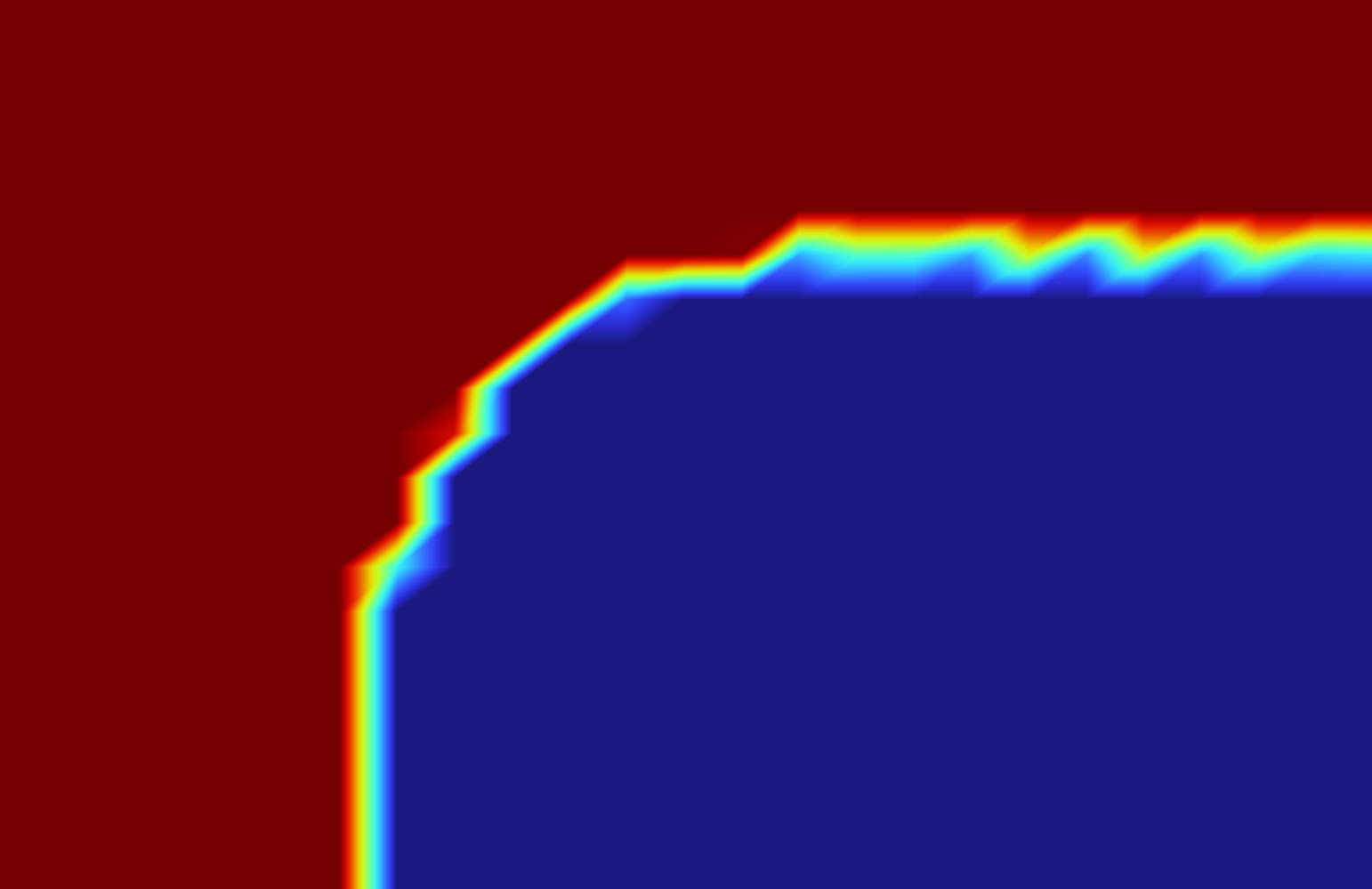

I define a fuction from an image. However, I find the accuracy of my original image has been compressed. I hope every pixel is consevered. What should I do?

Make sure your computational mesh is sufficiently fine when you call the function, so that it samples the image data properly. I find the "Plot" button on the function window useful as a preview, but you can get the data sampled finer by using a fine computational mesh.
