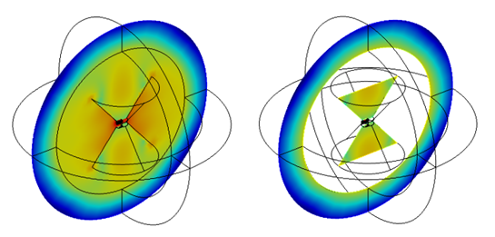

I'm new in COMSOL and RF modeling so I started with building existing models from model gallery by following given instructions. At the moment I'm simulating model Biconical Antenna.
The results (S-parameters) I got are correct, but multislice view is what actually bothers me. The picture of multislice views are in attachment. When i simulate existing model (from models\RF_Module\RF_and_Microwave_Engineering) I get multislice view on the left, but when I simulate model that I made by following the instructions, I get multislice view on the right. I've tried to find difference in result settings, but I couldn't find one.
Did I make some mistake and how could I correct it?
