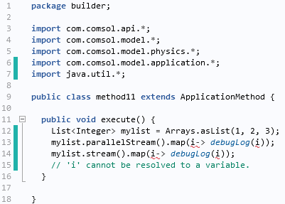

HI Edgar, thanks for answer.
There is way to use methods during computatin but basically I use JAVA methods for post processing.
The example I provided is legit JAVA code which works but not in Comsol.
Thanks for the idea with external DLL. It's great and useful tool but it does not fit what I want to try.
For example we have parametric sweep with 3 steps, where 1, 2, 3 are indeces of those steps. In postprocessing we need to perform Global Evaluation
for each step independently.
I will omit imports, class name and execute
method of the class method11
and show simple example:
int[] indeces = new int[]{1, 2, 3};
for (int i: indeces)
with(model.result().numerical("sol2"));
set("outersolnumindices", i);
endwith();
model.result().numerical("gev1").setIndex("expr", "2+" + toString(i), 0);
model.result().numerical("gev1").setResult();
double[][] table = model.result().table("tbl1").getReal();
Previous code is a sequence. Next example suppose to be legit equivalent of previous.
List<Integer> mylist = Arrays.asList(indeces);
mylist.parallelStream().map(i-> {
endwith();
// 'i' cannot be resolved to a variable.
But this code should run for each index i
an independent subprogram in the same time.
I suspect that it's impossible to do in the way I want but at least to have an option to run parallel JAVA code would be nice.
Best Regards,
Kostiantyn Vasko
For example we have parametric sweep with 3 steps, where 1, 2, 3 are indeces of those steps. In postprocessing we need to perform `Global Evaluation` for each step independently.
I will omit imports, class name and `execute` method of the class `method11` and show simple example:
endwith();
List mylist = Arrays.asList(indeces);
endwith();
But this code should run for each index `i` an independent subprogram in the same time.
Best Regards,
Kostiantyn Vasko
