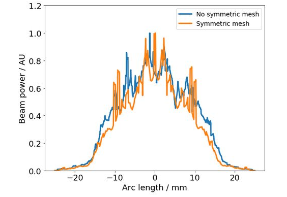

I am trying to solve an electromagnetic wave propagation problem with a frequency of 140 GHz (which corresponds to a wavelength of 2.14 mm).

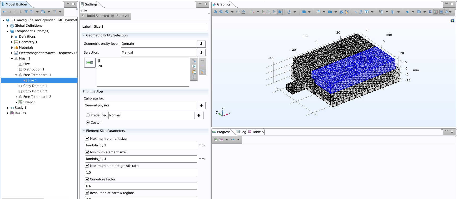

My issue is the results seem to have quite bad resolution (attached screenshot of the wave power). I am using an adaptive mesh, which scales from wavelength / 2 to wavelength / 4 (attached screenshot with the mesh of the model). Since my problem is axis-symmetric, I tried to create a symmetric mesh, by copying the domain of the one half to other half (the orange curve in the graph). Even with this trick, however I was not able to increase the mesh resolution, as the model was running out of memory while solving the problem (when I tried to scale the mesh from wavelength / 4 to wavelength / 6 for example).
Is there any idea how can I increase the resolution of the results without necessarily pushing the mesh resolution way too high?
