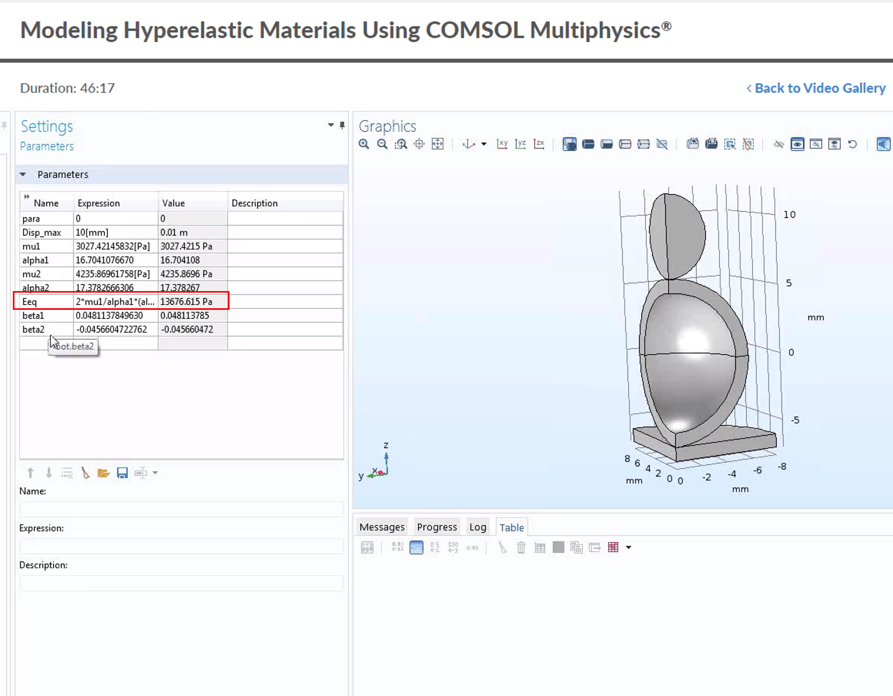

                                                    Dear Henrik,
Thanks for the reply. Is there any way to get that equation? I am curious how to define the equivalent Young's modulus in especially that equation.
I found one in  Storakers, Eeq = 9*((2/3+2*beta1)*mu1+(2/3+2*beta2)*mu2)*(mu1+mu2)/(3*((2/3+2*beta1)*mu1+(2/3+2*beta2)*mu2)+mu1+mu2), but the value is slightly off.
Thanks.

                            Dear Henrik,
I found one in  Storakers, Eeq = 9\*((2/3+2\*beta1)\*mu1+(2/3+2\*beta2)\*mu2)\*(mu1+mu2)/(3\*((2/3+2\*beta1)\*mu1+(2/3+2\*beta2)\*mu2)+mu1+mu2), but the value is slightly off.
Thanks.
B.T.

                                                    Sorry, I am not certain that I understand the question. Are you asking about the derivation of the expression above for the Storakers material?
Basically, you compute the shear modulus (G) and bulk modulus (K) analytically from the strain energy density equation, linearized at zero strain. Then,  E_equ=9K*G/(3K+G) using expressions from linear elasticity.
