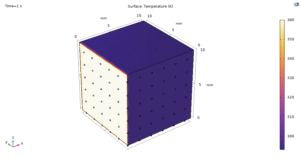

I'm grateful for response. I successfully created the geometry of nanocomposite. The only one problem now is how to measure thermal conductivity? Is there some standart algorithm in COMSOL?

You derive the equivalent conductivity of a sample from the formula q=-k*grad(T) .
You run a simulation with an imposed heat flux through the sample and obtain from that simulation the temperature drop; then using the formula above (and the length of the sample, as you can approximate ) you get k.
