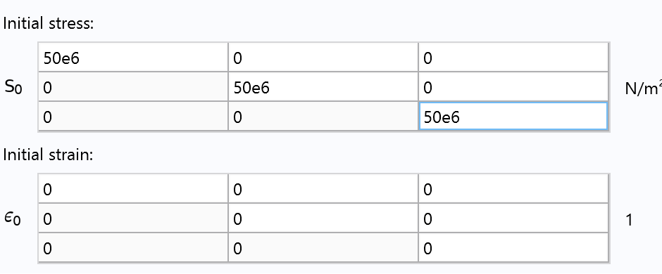

Thank you very much for your kind reply sir,
my membrane is a 3D model.

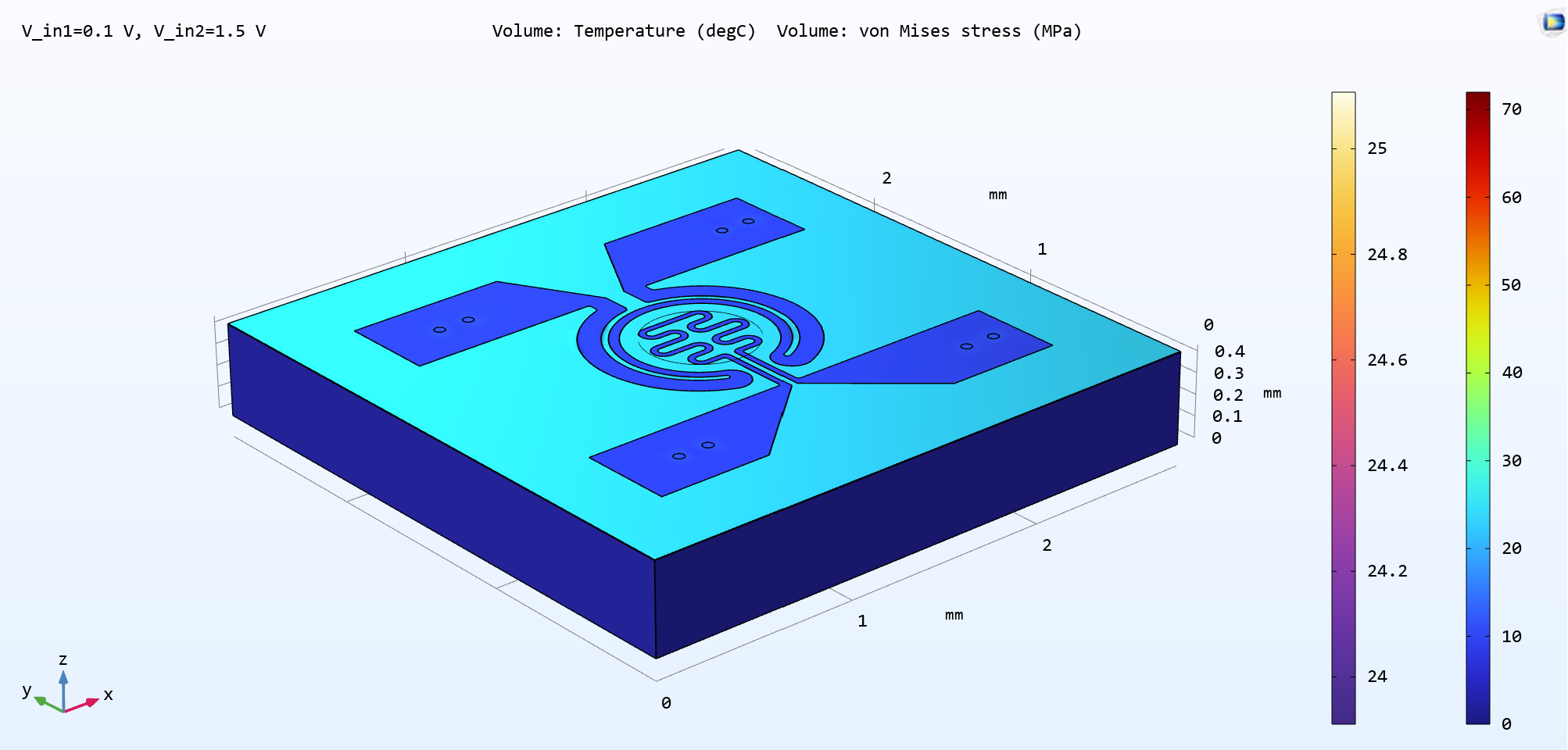

Actually we check the intial stress 50 MPa at room temperature with some experimental equipment. I subsititute initial stress 50 MPa in principal diagonal of the matrix in x,y,z directions. After the simulations i checked the initial stress at room temperarure (25 degree). it is showing 70 MPa at room temperature.
I am applying the intial stress right?
or the results are fine?
Thanks again for your reply.
Have a good day.
regards
