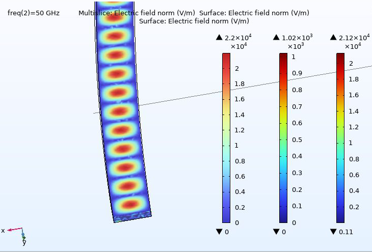

I am simulating mode conversion ( TE10 to TE20) on a hollow curved waveguide of rectangular section. On the Port section I inserted Phase=0 for both ports (input and output). I don't understand why on Port 2 (the output Port) the field is always (almost) vanishing even if I change wavelength, i.e. exp(ikz_port2)=0 (where z is the direction of the waveguide axis). Intuitively I would expect that, based on the relation bewteen wavelength and length of the guide, on Port 2 the solution would change the value of the exponential part (i.e. the part propotional to exp(ikz)). Why this behaviour?

What did you specify in terms of the detailed boundary conditions on your ports? If both TE10 and TE20 modes are above cutoff, then to model this properly, and assuming a clean launch of TE10 at one end, then you need to specify TE10 and TE20 port conditions on both your physical ports, but with distinct port numberings for each distinct mode.
Input port (to be overloaded with two port specifications): Port #1: Specify TE10, with Port "ON" (Note: Only this one is set to "ON"). Port #2 (select same physical port as Port #1!!): Specify TE20, with Port "Off" (This lets it absorb reflected waves in TE20 mode).
Output port (again, to be overloaded with two port specifications): Port #3: Specify TE10, with Port "OFF" (This will absorb TE10). Port #4 (select same physical port as Port #3!!): Specify TE20, with Port "OFF" (This will absorb TE20).
This allows your single excitation of a TE10 mode at your input port to accept: 1: Reflections, if any (to the input port) as a TE10 mode. 2: Reflections, if any (to the input port) as a TE20 mode. 3. Transmission (to the output port) as a TE10 mode. 4. Transmission (to the output port) as a TE20 mode.
The s parameter corresponding to TE20 output (at the output port), if given a TE10 input (at the input port), will then be emw.S41 . You can (and should) use the argument of that complex quantity to find the phase. Similarly, you can also quantify amplitudes and phases of the reflections and the transmitted TE10. To extend to even higher modes, specify more ports. (I've overloaded ports with up to dozens of modes, so I know this works.)

In your waveguide, the cutoff frequency for the TE20 mode is 52.7804 GHz. You were running your model at 50 GHz. This is below the cutoff frequency, so TE20 will not propagate. Either make your waveguide wider or run your model at a higher frequency, if you want to allow the possibility of a TE20 mode to appear.
p.s. On a separate matter, I notice you are plotting sqrt((emw.Ez)^2+(emw.Ex)^2+(emw.Ez)^2). That is not the norm of the field, since E is complex. Instead, I would encourage you to plot emw.normE . If you want to "see" the wave in the guide, then (in your case) plot emw.Ez
