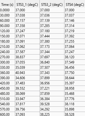

As for the time-stepping: Once I change it to 20 seconds (I also tried 10s), it produces very weird jumps in temperature, that are also not explainable. I attached an image of the table.

Thank you very much for both of your replies! Unfortunately both suggestions don't work out for me. I tried really hard to create a swept mesh but am unable to. I always get errors. I read through the [tutorial](https://www.comsol.com/support/learning-center/article/Introduction-to-Swept-Meshing-51861/152) and tried to gain knowledge from the [bipolar transistor example ](https://www.comsol.com/model/3d-analysis-of-a-bipolar-transistor-19699) but I simply can't produce a swept mesh. As for the time-stepping: Once I change it to 20 seconds (I also tried 10s), it produces very weird jumps in temperature, that are also not explainable. I attached an image of the table. I would be very grateful for additional help.

I rebuilt the whole model step by step and found out that the weird results came by adding the vias. Because when adding the vias, I could not create a swept mesh anymore as the vias throw a "Unsupported topology of linking face" error.
That's why I exchanged the vias with cylinders with the same volume as the ring of the via. I can now create a swept mesh and get results that seem plausible.
This is not a solution however, just a workaround.
I rebuilt the whole model step by step and found out that the weird results came by adding the vias. Because when adding the vias, I could not create a swept mesh anymore as the vias throw a "Unsupported topology of linking face" error. That's why I exchanged the vias with cylinders with the same volume as the ring of the via. I can now create a swept mesh and get results that seem plausible. This is not a solution however, just a workaround.
