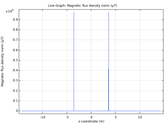

Hey everyone,

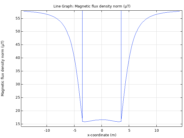

I'm currently dealing with a COMSOL model where the faces of a box are extruded to incorporate nonlinear magnetic material later on. As a result, I've noticed a peak in my graph (please refer to the attached image) due to the small surface area. While I know the cause of this peak and it's not a major issue, I'm curious if there's a way to eliminate these peaks directly within COMSOL. Currently, I export the data to MATLAB for post-processing to address this.
Thanks in advance for any insights.
Best regards.

Hi Jirka,
It should be possible to remove them from the plot with a suitable logical expression using a Filter subnode.
Best regards, Magnus
