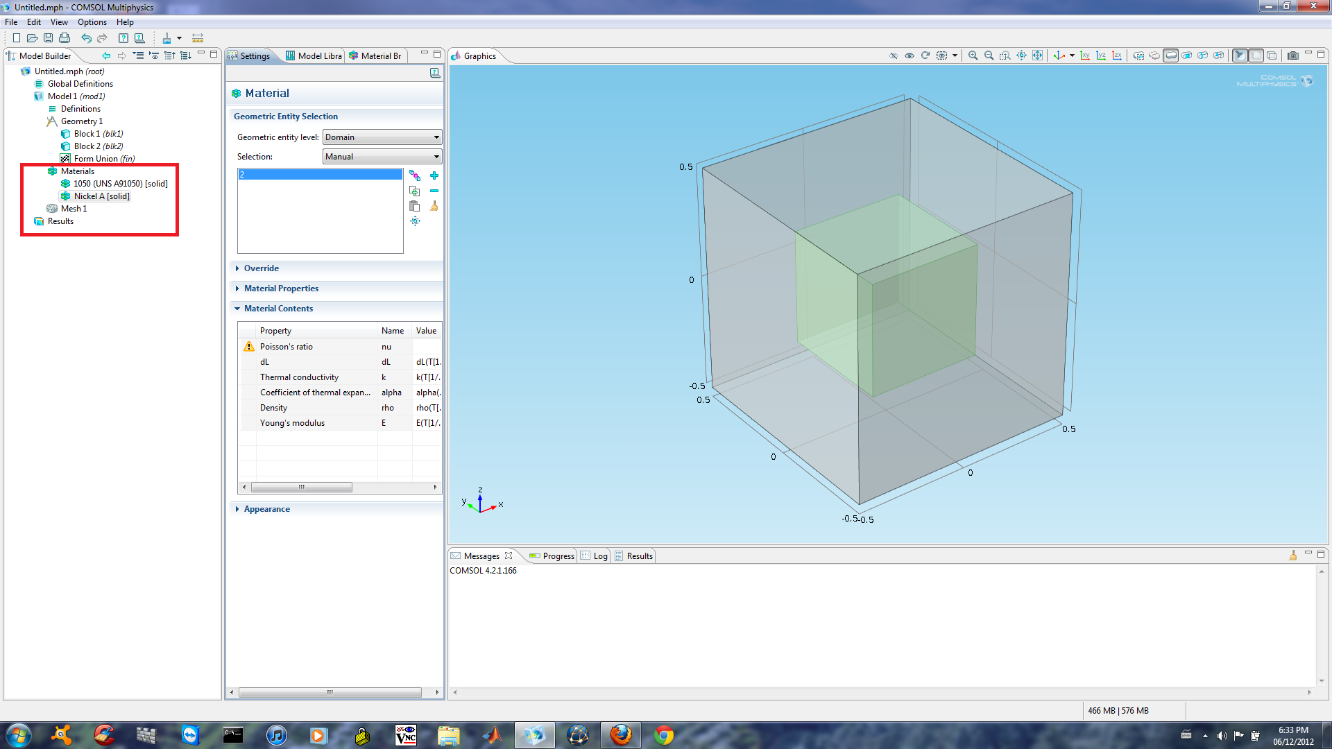

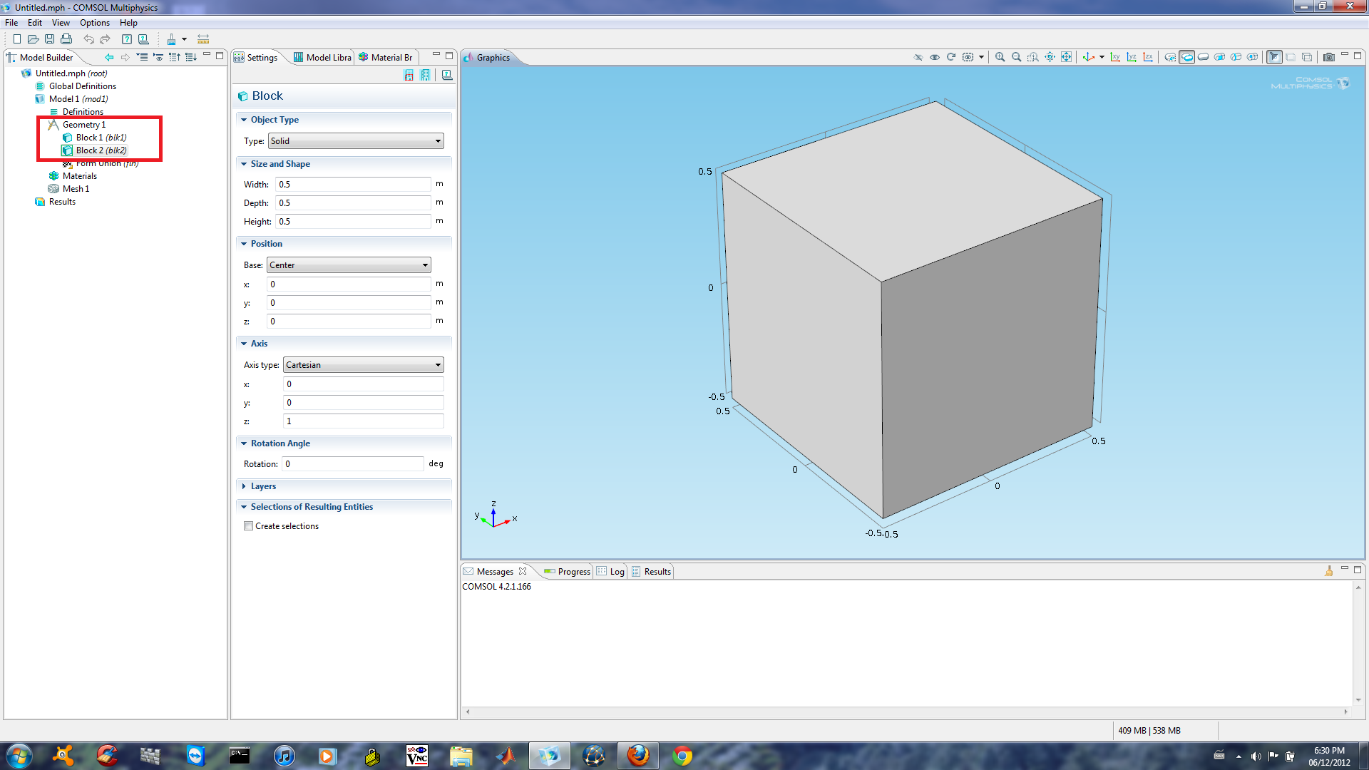

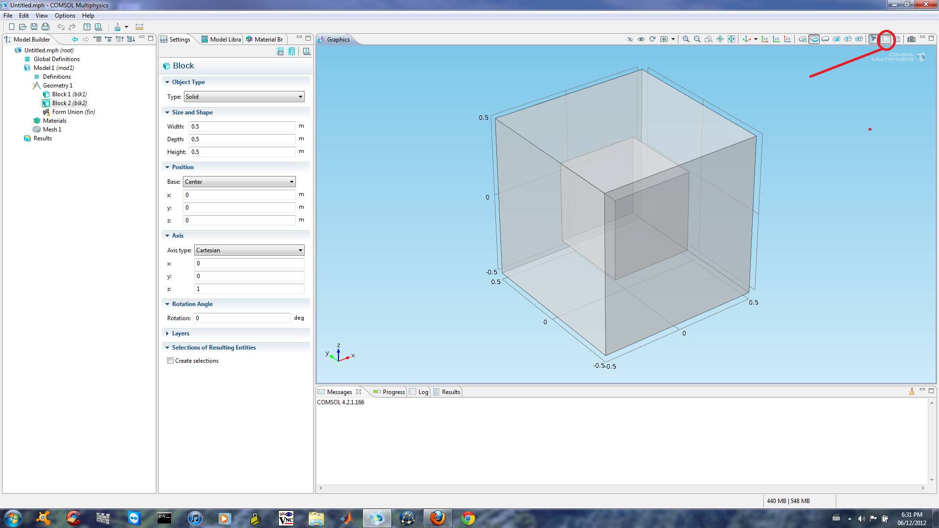

attached find the image files of the model. First create two blocks of different size (_1), then go to transparent option (_2), go to material and select the materials that you want and define them under domains selecting any domain (block) you want (_3).
cheers
Mayur
Hi, attached find the image files of the model. First create two blocks of different size (_1), then go to transparent option (_2), go to material and select the materials that you want and define them under domains selecting any domain (block) you want (_3). cheers Mayur

Thanks Mayur,
it worked, but doing this I have four faces of inside cube of type " not applicable". Can I apply any boundary condition on that face?
Thanks Mayur, it worked, but doing this I have four faces of inside cube of type " not applicable". Can I apply any boundary condition on that face?

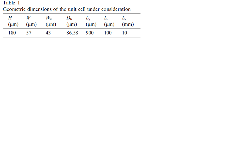

But Still the geometry what i was planning to desing has dimebsion
100X900X10000
Where each heat sink has dimension 57X180X10000
and there is equal length from each node in X-direction.

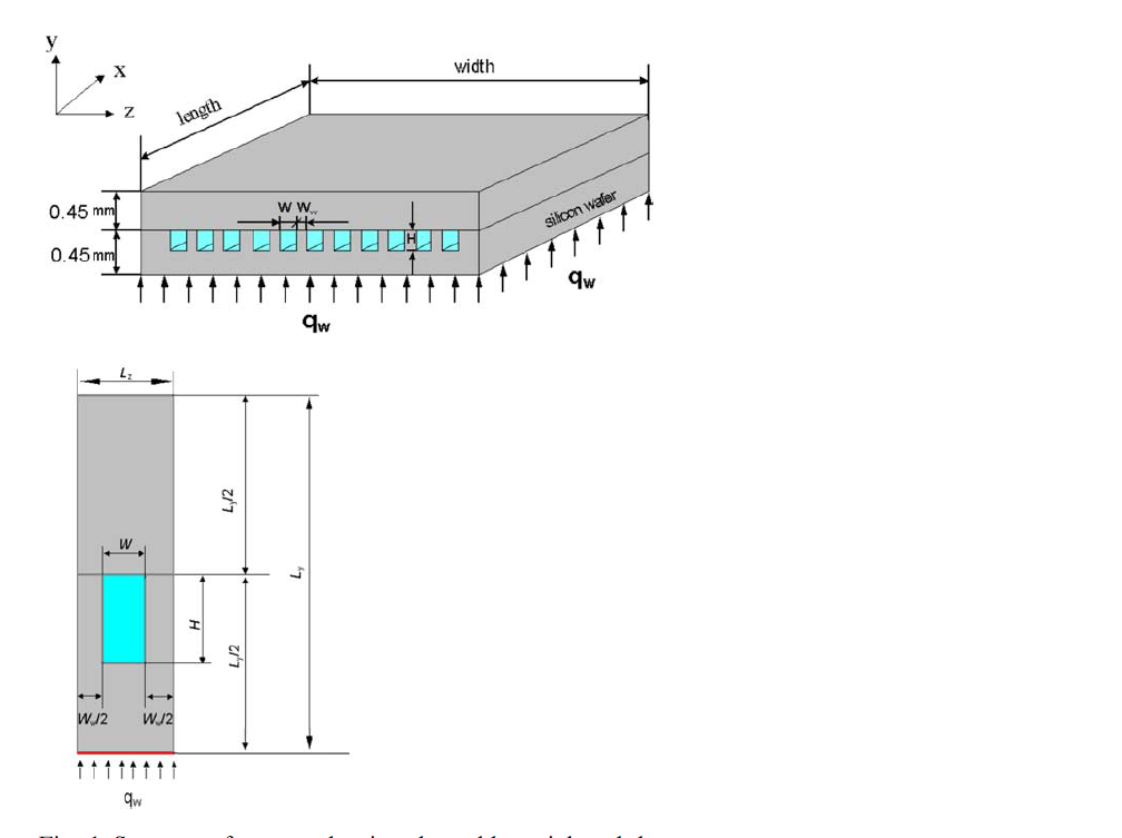

I am attaching the geometry of what I am trying to design with this. Where actually sink is somwhere inside the channel and not exactly at the base how you defined in the model.
So I think I have to use boolean operator.
But When I am using boolean operator some of the surface creates like " over ridden"
Thanks again,
Purvi

are you trying to replicate the result published in International Journal of Heat and Mass Transfer 47 (2004) 4215–423?
Posted: 1 decade ago 8 déc. 2012, 02:59 UTC+1
Yes, I am trying to use this geometry for my practice.
Posted: 1 decade ago 8 déc. 2012, 03:00 UTC+1
I mean same geometry of International Journal of Heat and Mass Transfer 47 (2004) 4215–423?
Posted: 1 decade ago 8 déc. 2012, 03:12 UTC+1
okay, after looking at this paper, it seems water is flowing through the cyan color channel (Fig 1 and 2 in paper), actually you tried exactly opposite to what is given in the paper.
