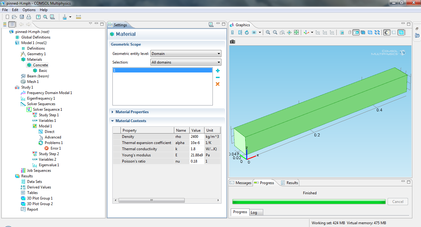

Dear Ivar;
this is a screenshot from my model.
material properties and some other features are shown.
Dear Ivar; this is a screenshot from my model. material properties and some other features are shown.
Posted: 1 decade ago 16 déc. 2012, 15:18 UTC+1
I missed the "edge" word in your error message, I stopped at "rho". The issue is that you use a "beam" phyiscs that is defined on edges only, while you are in 3D with a "domain" = volume, but the "domain" for "beams" are lines = edges.
So first of all you must define the material on the EDGES in the material node, as these are by default set to the highest order of the geometry = 3D volume = DOMAIN as you can see on your image too.
I agree this is confusing, the COMSOl developers could perhaps improve this, but it's far from obvious how, as "beam" phyiscs is special physics using geometrical entities 1 or 2 dimensions lower the the default geometrical domain entitiy.
So start to select edges for the material, as beams are lines=edges in 3D (or 2D if you have defined highest order = 2D)
And read through carefully the doc about geoemtrical objects, fem entities, physics on domains (but domains size depends on physics too) ...
Hi I missed the "edge" word in your error message, I stopped at "rho". The issue is that you use a "beam" phyiscs that is defined on edges only, while you are in 3D with a "domain" = volume, but the "domain" for "beams" are lines = edges. So first of all you must define the material on the EDGES in the material node, as these are by default set to the highest order of the geometry = 3D volume = DOMAIN as you can see on your image too. I agree this is confusing, the COMSOl developers could perhaps improve this, but it's far from obvious how, as "beam" phyiscs is special physics using geometrical entities 1 or 2 dimensions lower the the default geometrical domain entitiy. So start to select edges for the material, as beams are lines=edges in 3D (or 2D if you have defined highest order = 2D) And read through carefully the doc about geoemtrical objects, fem entities, physics on domains (but domains size depends on physics too) ... -- Good luck Ivar
Posted: 1 decade ago 17 déc. 2012, 13:06 UTC+1
Thanks a lot Mr. Kjelberg
It is worked correctly. I selected all edges instead of all domain.
