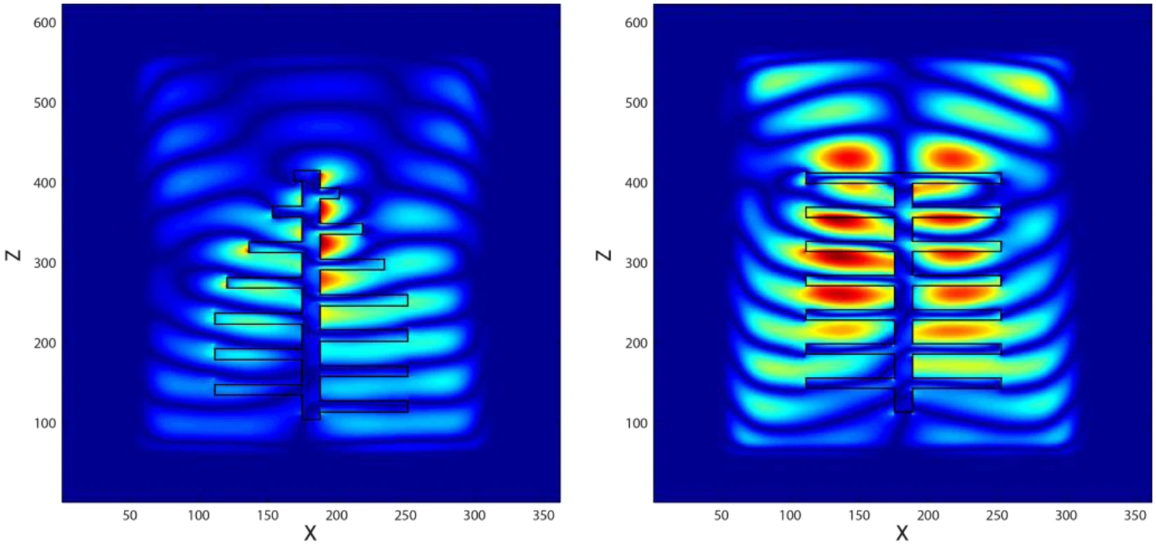

I aim to achieve a reflection graph similar to Figure 2 in the following paper, which served as the basis for my simulation:see picture below. I am striving for a reflection graph akin to the electric field in Figure 2 or as shown here: see picture below.
Unfortunately, my current reflection graphs do not make much sense. Can anyone pinpoint where exactly my problem lies? Below, you can find my file, and I am working in Study 3. Thank you very much!
