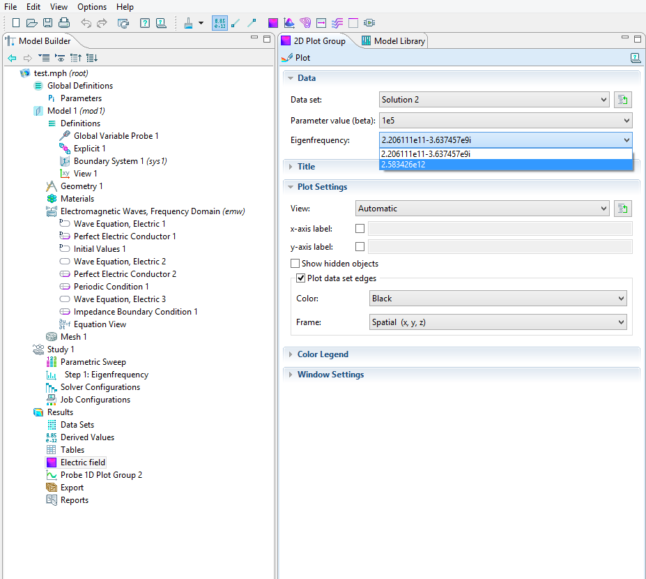

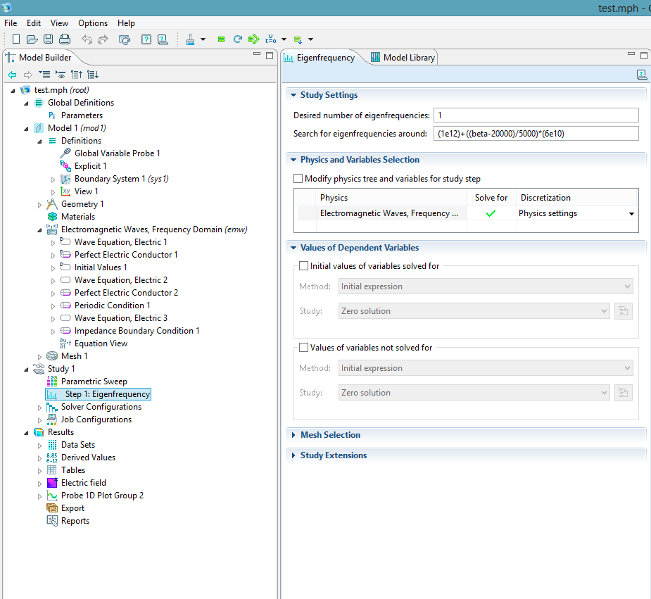

I'm performing an eigenfrequency analysis of a model in the Comsol 4.3a RF module. My problem is that, though I ask for only 1 eigenfrequency, Comsol ALWAYS gives me 2 eigenfrequencies: one purely real, and one complex. This is frustrating me because when I try to probe the eigenfrequency, it always probes the wrong eigenfrequecy (the complex one), so the only way I can extract the data for a 50 point sweep is to manually go through and extract the proper eigenfreq. The correct eigenfreq is always at the bottom of the dropdown menu, which in previous versions of Comsol always corresponded to the first solution.

1. Figure out how to make Comsol only give me 1 eigenfrequency (should work if the bottom solution does still correspond to the first one it found).

I understand the meaning of a complex eigenfrequency, my problem is simply that I ask for 1 eigenfrequency, yet comsol insists on giving me 2 eigenfrequencies, which is a problem for me. I don't know why comsol is doing this, but there is another solution to the problem. Let me phrase it this way:

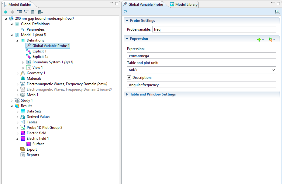

Right now I have a probe that is set to probe the expression "emw.omega" (see attached screenshot), however, comsol solves for multiple eigenfrequencies, so it is finding several emw.omega values. If I probe emw.omega, it only probes the most recent emw.omega (ex. if I solve for 6 eigenfreq, it will output the 6th eigenfreq). In previous versions of comsol, if you wanted to probe say the 3rd eigenfrequency, you would simply probe "emw.omega(3)". Comsol 4.3a rejects this, so my question is, do you know how to tell the probe which solution to observe?

have you tries with the with(3,...) operator ? (you also have the at() for time series) there are many new operators in v4.3a, check the help on "operators". This might give you the solution. I do not know why you getr several modes, the best is to ask support for such things ;)

Comsol gives additional eigen-frequencies when there is no extra computational effort by the solver.
