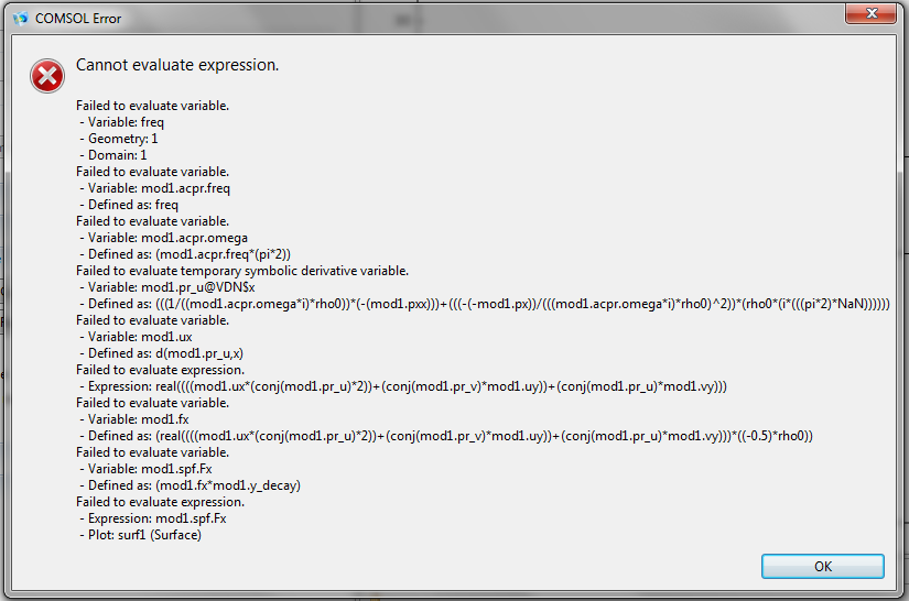

I'm new to using the v4.x series of COMSOL, so perhaps I've missed something simple, but I get an error when trying to plot body volume force variables. The error message states:
"Cannot evaluate expression.
Failed to evaluate variable.
- Variable: freq
- Geometry: 1
- Domain: 1
- Variable: mod1.acpr.freq
- Defined as: freq
and continues down to mod1.spf.Fx which I am trying to plot (see attached image).
I have used the Pressure Acoustics module along with the Laminar Flow module. I set the solver to first solve Pressure Acoustics in the frequency domain (Step 1), then a combination of parameters from Pressure Acoustics is used to calculate body forces in the Laminar Flow module. Stationary analysis is used to solve for the Laminar Flow physics (Step 2).
Has anyone had this problem before? Is there an easy way to fix this problem?

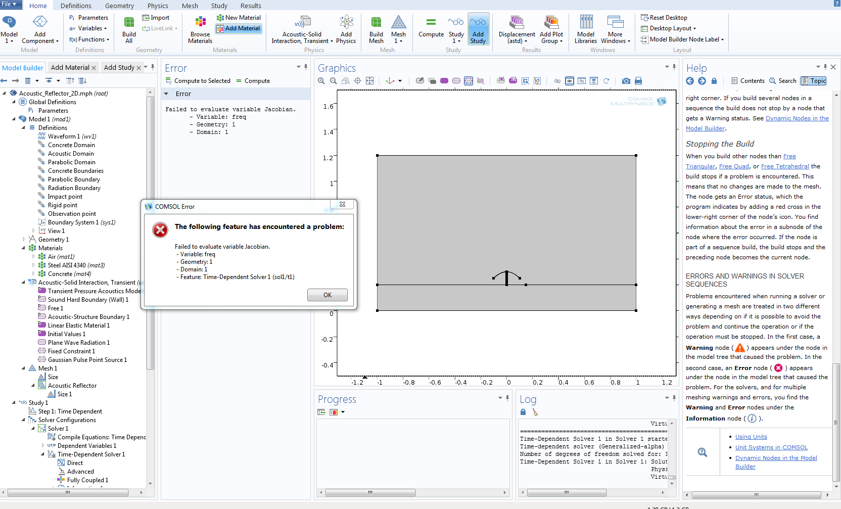

Hi, Sergei,
I think I have the pretty similar trouble as the one you solved. Could you take a quick look at the attached file and help me fix the problems.
Thanks in advance on your comment.
Ji
