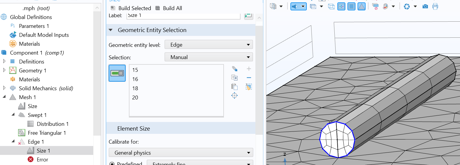

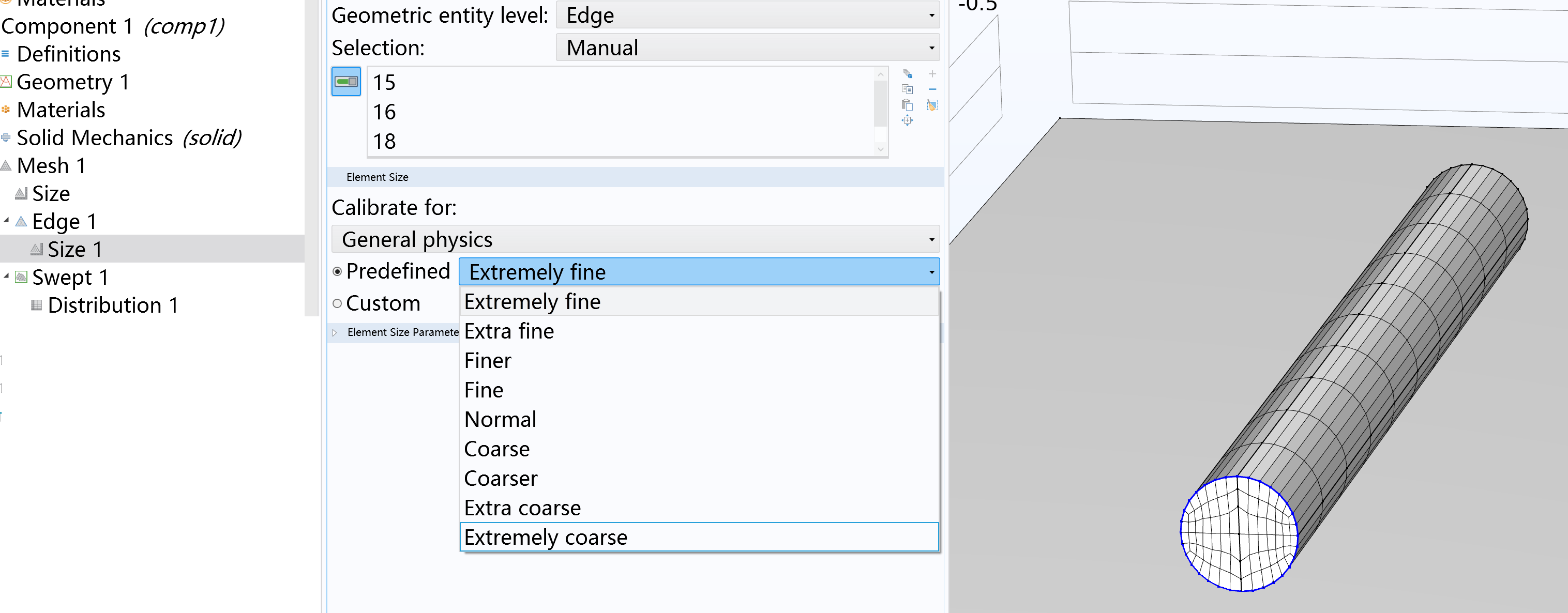

Posted: 2 years ago 13 avr. 2024, 02:36 UTC−5
Hi Magnus, Thank you so much. I followed your advice but found that Edge 1 and swept 1 don't play well together. I specify first the mesh density to be extremely fine in Edge 1, then specify the element numbers swept 1, the latter overthrowing the former.
Magnus Ringh COMSOL Employee
Posted: 2 years ago 15 avr. 2024, 02:01 UTC−5
Hi Carl,
This approach works well for me in version 6.2. I suggest that you contact COMSOL Support for any specific issues that you may have with your model.
Magnus
Hi Carl, This approach works well for me in version 6.2. I suggest that you contact COMSOL Support for any specific issues that you may have with your model. Best regards, Magnus

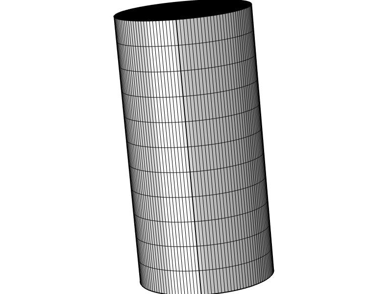

Posted: 2 years ago 26 avr. 2024, 22:30 UTC−5
Hi Magnus thank you. I followed your advice as attached. The only weakness for me is that on the circular boundary the mesh is too biased. Is it possible to build one that is not so biased in the two perpendicular directions?
Posted: 2 years ago 2 mai 2024, 02:55 UTC−5
Hi Carl,
I guess it's a matter of designing a suitable face mesh on the bottom boundary. I'm not sure that I can assist with further advice here. Please contact the COMSOL Support team if you have additional questions.
Magnus
