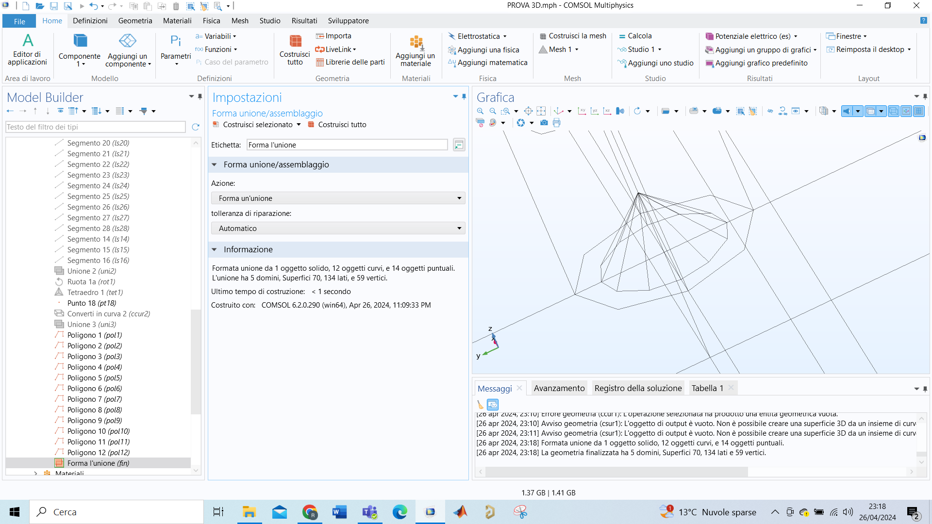

Hello guys! I'm asking if it's possible to build a pyramid based on dodecagon in 3D geometry. I tried to draw polygons and then convert them first in surfaces and then in solid but it doesn't work. I'm wondering if it's possible or not. Hope you'll help me! Kind regards and have a nice weekend!

You can follow the approach shown in the attached file: start by creating the dodecagon (Note the use of the range function) in a workplane, and then extrude with a scaling factor of 0.
Hello Raffaella, You can follow the approach shown in the attached file: start by creating the dodecagon (Note the use of the range function) in a workplane, and then extrude with a scaling factor of 0. Best, Jeff
