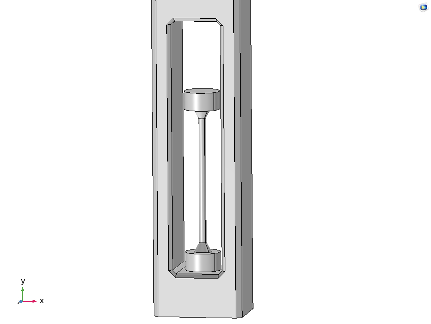

Im currently working on a Eigenfrequency Prestressed study.

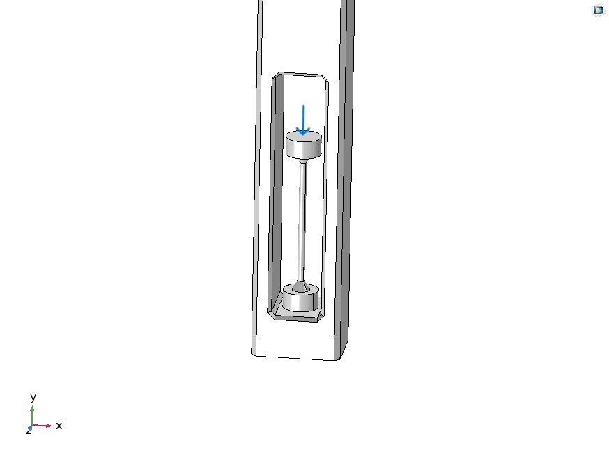

I want to put a point mass at the top face of the lower flexure (see the image below)
I attached another image that show where i want the point mass (see the image with the blue arrow).
For referance I attach the mph.file for the system that is used for the simulation and a image of what it look like.
Before I put a point mass I use a cube with a very high density with interia and placed it where arrow is at but it won't be useful for long term research, and before I use a point load but it have no mass of interia.
An idea that I have is to use a added mass load but it only for boundary but I am not sure it a correct substitute for the point mass.
Any help or advice much appreciated thank you.

There is no point mass feature in the Solid Mechanics interface. The reason is that a point mass causes a type of singularity, similar to a concentrated force. It is better to distribute the mass over some small boundary, using an Added Mass node.
You can also use a Rigid Connector with a Mass and Moment of Inertia subnode. Note that you can select a flexible formulation, if the constraints imposed by the rigid connector are too hard.
Henrik Sönnerlind
COMSOL
There is no point mass feature in the Solid Mechanics interface. The reason is that a point mass causes a type of singularity, similar to a concentrated force. It is better to distribute the mass over some small boundary, using an **Added Mass** node. You can also use a **Rigid Connector** with a **Mass and Moment of Inertia** subnode. Note that you can select a flexible formulation, if the constraints imposed by the rigid connector are too hard.
